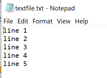

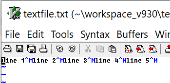

  • You can write the character \r out into a text file.  That causes a character with the decimal value 13 to appear at that point in the stream of characters.  How that gets interpreted depends on the software used to display the text file.
    As an example, consider this code ...
        for (i = 1; i <=5; i++)
            fprintf(fptr, "line %d\r", i);
    Note the use of \r instead of \n.  I ran this on an ARM system under control of CCS, which is installed on a Windows system.  Here is how Notepad displays these lines.
    Here is how gvim (a Windows variant of the Unix editor vi) displays the same lines.
