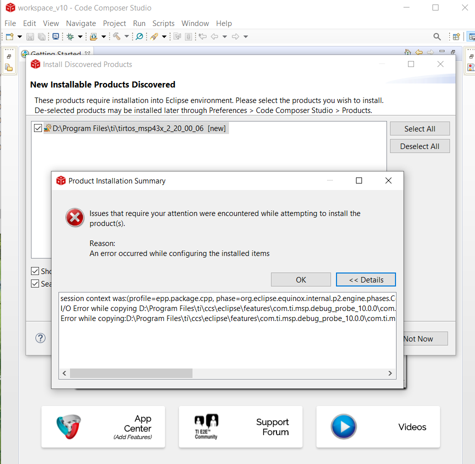

While I was installing RTOS 2.20.00.06 on CCS 10 I had this error message :
An error occurred while configuring the installed items
session context was:(profile=epp.package.cpp, phase=org.eclipse.equinox.internal.p2.engine.phases.Configure, operand=null --> [R]com.ti.msp.debug_probe.zipselector.notmac 10.0.0, action=org.eclipse.equinox.internal.p2.touchpoint.natives.actions.CopyAction).
I/O Error while copying D:\Program Files\ti\ccs\eclipse\features\com.ti.msp.debug_probe_10.0.0\com.ti.msp.debug_probe.properties - see details.
Error while copying:D:\Program Files\ti\ccs\eclipse\features\com.ti.msp.debug_probe_10.0.0\com.ti.msp.debug_probe.properties
I have no idea how to fix it and I tried everything.
Thanks you a lot for any reply
    It is not recommended to install CCS in a path with spaces like "D:\Program Files". It can cause various issues with building and updates. Could you try installing CCS in a different directory without spaces? Sorry for the inconvenience.
    ki
  • I finally succeeded to install it in admninistrator mode. But indeed I had an other problem due to the path and I had to change it.
    Thanks you for your help !
