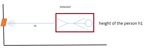

Could you please tell me the feasibility of understanding fall detection using IWR1642.
  1. Currently I am using IWR1642 device for tracking people.
  2. With the help of Raspberrypi , oob_parser and 2D People counting, I am getting 2D people count data of a person.
Scenario 1:
At T time, person will be standing in front of sensor, using 2D people cloud point data, I have to calculate dimension of the that person.
From forum, I got to know that height of the person will be calculated by "Sensor's height - Measured Length"
Query #1:
How to calculate Length / dimension of the person using 2D point cloud data?
Is there any oob_parser available for “Level Sensing” (To identify the distance from sensor)?
Scenario #2:
At T + n time, person is falling down
Query #2:
When a person fall down, how do I identify fall detection using cloud points?
Please clarify.

  • Hi Vivek,
    The tracker returns a TLV called track index. This is a mapping between tracks and points -> tracker index is a array of uint8, index corresponds to a point. So if tracker index[4] is 2, then pointCloud[4] is associated with track 2. Please note that point cloud output is always frame N, and tracker output is always frame N-1, so you need to save the point cloud for one frame.
    With the above information, you can get all of the points associated with the track. For height, take the highest point for the track, and average over 10 frames. A fall is detected when there is a large change in height. You could use similar techniques to try to estimate length, width, height. This technique works well for fall detection because we don't care about the true height of the person, just the relative change in height.
