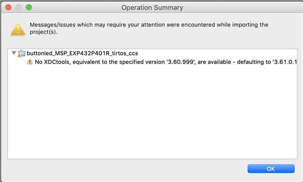

    I get this message when importing as my XDCTools verison is a bit different than the one specfied by the project:
    After clicking ok I end up with these two projects (yours would not have the top level MSP432P node as I created a working set to organize my projects).

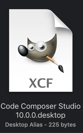

  • The only weird thing that happened was that for some reason gimp was grouped in the ccs1000 folder. I don't really know why. FYI Gimp is a knock off photoshop app that's free. Not sure if you want to try to replicate this, but that's what my installation looks like. Thanks for all the help!
  • Looks like Gimp associates its icon with .desktop.  It is doing something similar on mine but with a slightly different icon.  Looking at the file listing I can't see it but if I select the item to get the details I can see it.
