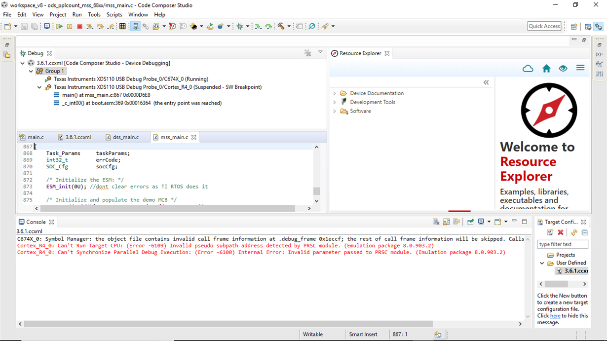

I am trying to do People Tracking and Stances by using the overhead people counting lab. When i run the lab in debug mode, it shows some errors related to PRSC module.
Please find the attaching file is for your reference:
Please help me to resolve this issue..

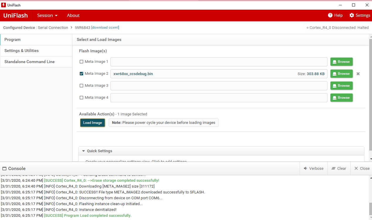

  • Hi Priyanka,
    Did you:
    1) successfully flash the CCS Debug firmware (xwr68xx_ccsdebug.bin) to the device?
    2) Have the SOP2 jumper open?
    ki
    Have done the above followings properly.
    Attached screenshot for your reference:
    -Regards,
    Priyanka

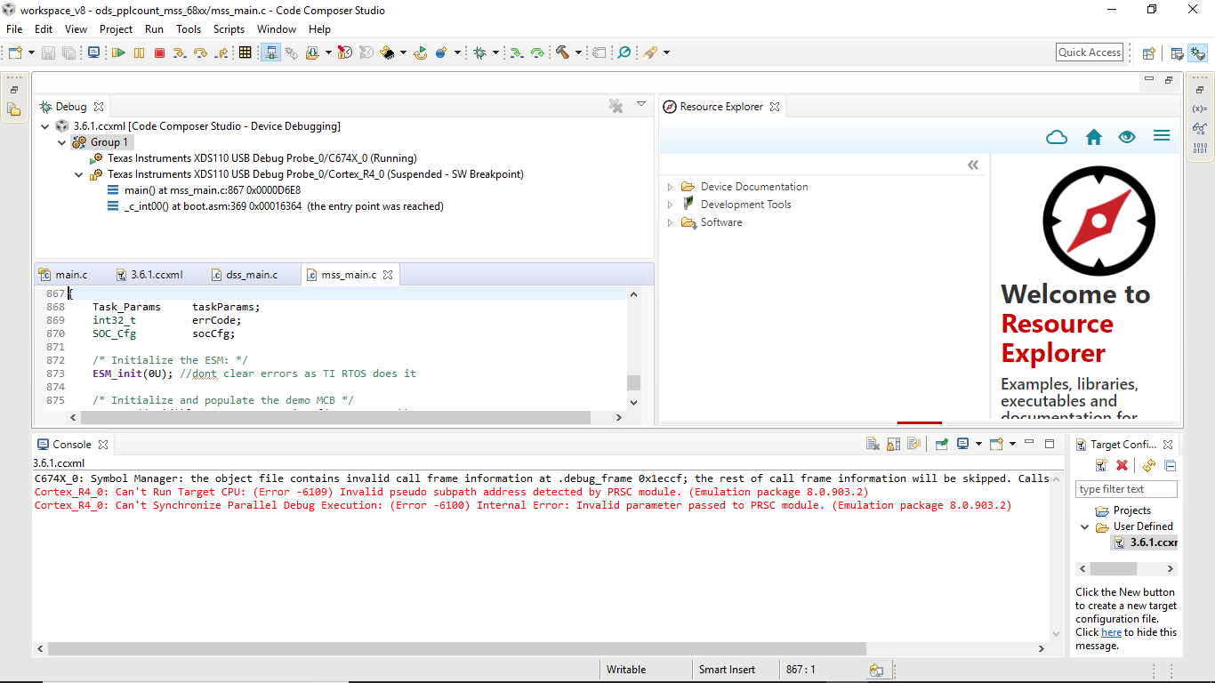

  • Looks like the debug image flashed fine. After you open the SOP2 jumper and start a debug session, can you connect to both cores?
  • Yes, SOP 2 jumper is opened once flashing has done. For flashing mode  only SOP 2 jumper was closed.
    After this created & launched the target configuration.
    Connected to target and loaded the program properly.
    Once i click on Run button, it shows the error in console which i have mentioned  above.
    -Regards,
    Priyanka
  • Note that you may need to do a full power cycle of the board before starting the debug session
  • Power cycled the device properly before when i start to debug.
    -Regards,
    Priyanka
  • Can you provide the executables for both the R4 and C674x that you are loading to the target?

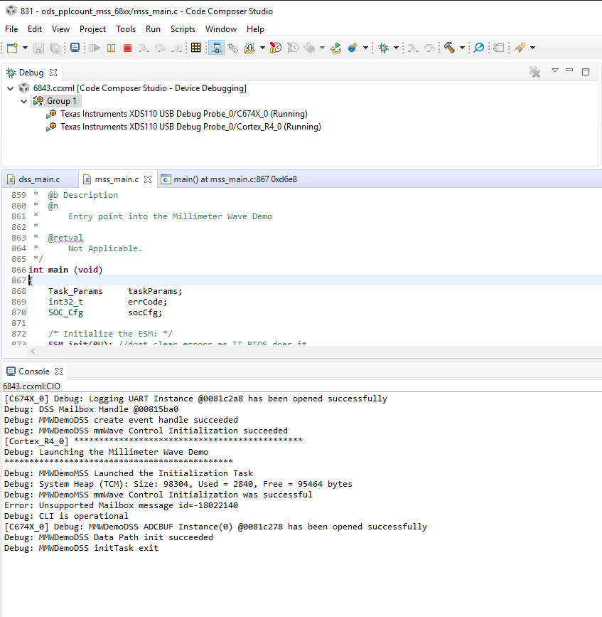

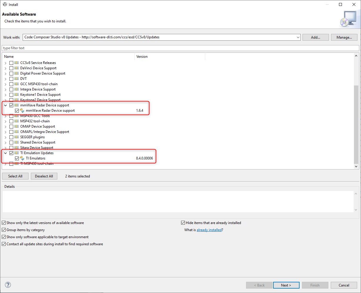

    I started a debug session in CCSv8.3.1 for my 6843ISK, grouped the cores, connected to each core, and loaded the DSS code, then the MSS code. Then I did a group run and it seems to work ok.
    Are those the same steps you did? I also flash the debug firmware from SDK 3.2.1.2 on my ES 1.0 target.
    I did notice that my TI emulators pack version is slightly newer than yours. You may want to update it.
    I also attached the ccxml file I am using:
    /cfs-file/__key/communityserver-discussions-components-files/81/6843.ccxml

    Please see the below link on how to run the updater in CCS:
    https://software-dl.ti.com/ccs/esd/documents/users_guide/ccs_updates.html
  • Thanks for your helping, am updating TI emulator version by refering the above given link.
    Once it is updated successfully, i will do the run the lab again.

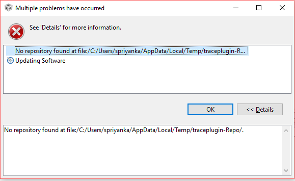

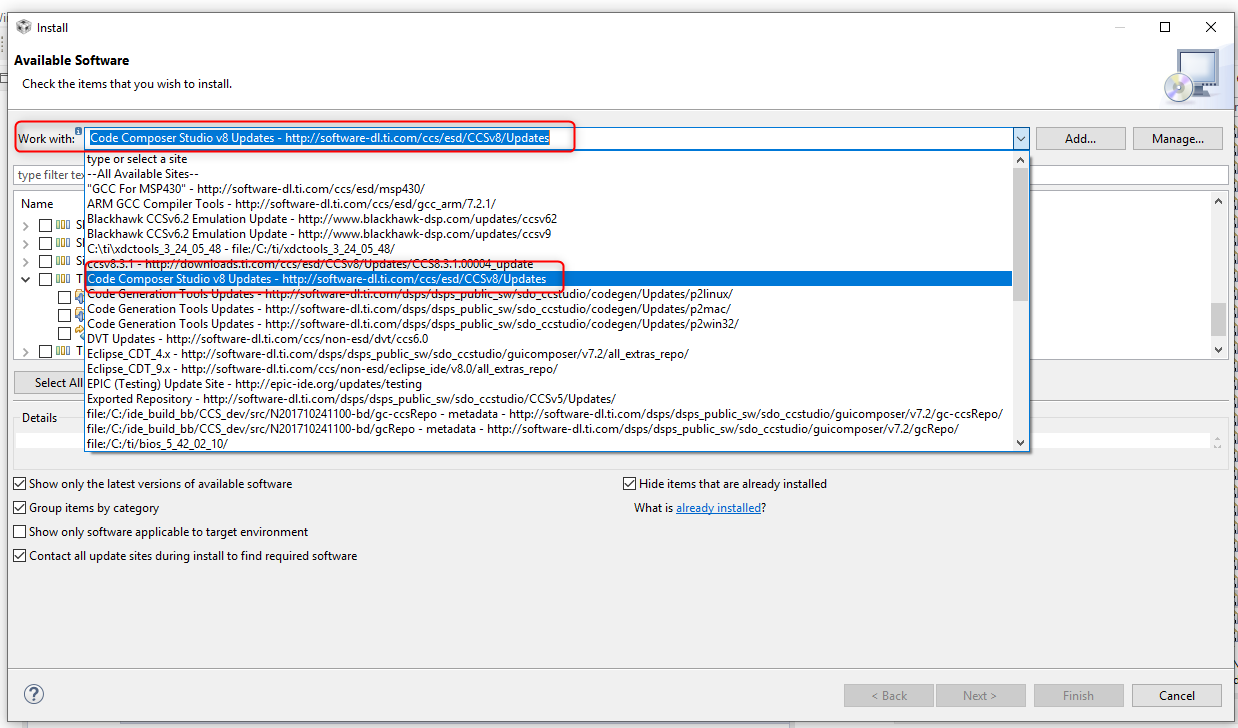

  • Update failed due to traceplugin repo file is missing.
    Help me to create that particular repo... Will share the error screen for your reference.
  • That looks like an invalid site. I'm not sure where that came from.

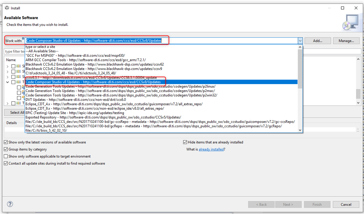

    I would do a targeted update check. Use the 'Help -> Install New Software' option and select the site highlighted below:
    ki

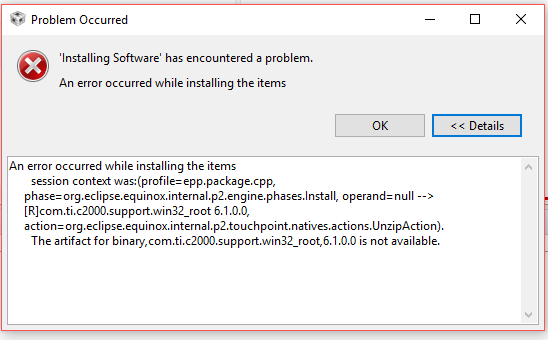

  • Still getting some error while updating the CCS v8.
  • Please only take the update for the TI Emulators:
  • There is also an mmwave update. I would take that one also:
  • hold on, I am getting update errors also. I will need to investigate further
  • never mind. It was just my one particular PC with the issue.

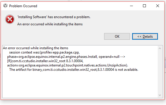

  • Followed your given steps, it shows problem with binary is not available for CCS V8.3.1

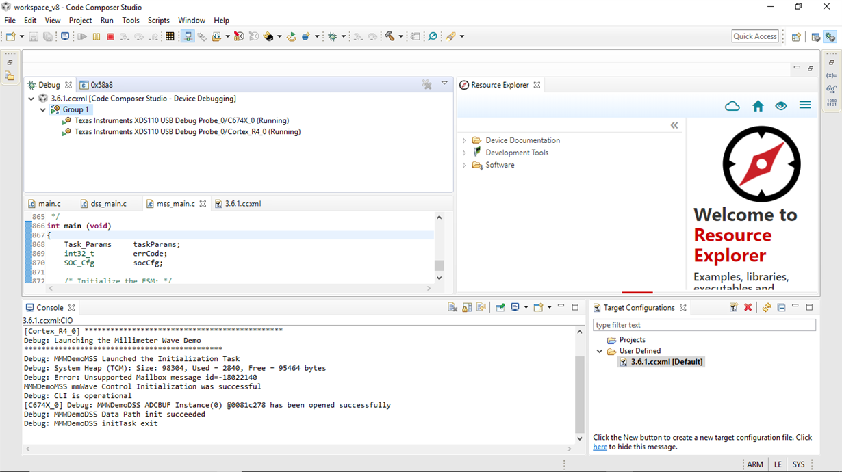

  • Thank you so much for the response. Have updated the CCS V8.3.1 now properly with the help of given link. So, i will debug it and update you the status.
    -Regards,
    Priyanka
    Thank you for the kind support.
    Debug has done properly with your sugesstions.
    But when i try to run the oob_parser, sensor_Start is not happened and there is not receiving any data from data port.
