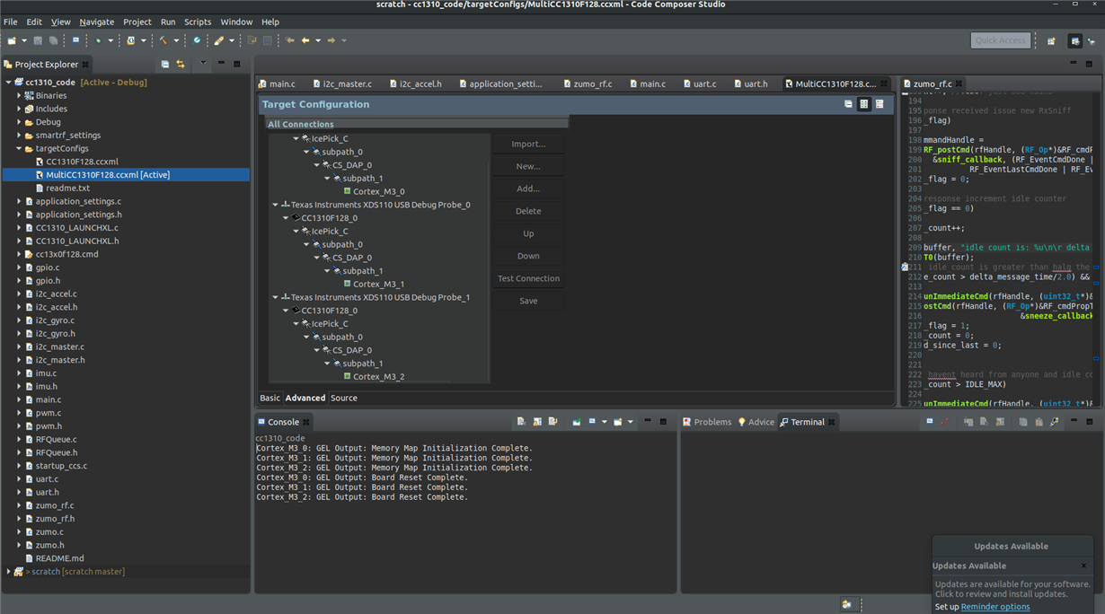

This is what my console output looks like:
Cortex_M3_0: GEL Output: Memory Map Initialization Complete. Cortex_M3_1: GEL Output: Memory Map Initialization Complete. Cortex_M3_2: GEL Output: Memory Map Initialization Complete. Cortex_M3_0: GEL Output: Board Reset Complete.
Included is a picture of my setup, but I followed: http://software-dl.ti.com/ccs/esd/documents/sdto_ccs_multi-probe-debug.html
Any help would be appreciated thank you!

    One aspect that is strange is that your Cortex_M3 cores are numbered sequentially, while in my case they all have the suffix _0 and the differentiator is done per debug probe. What version of CCS are you using? Did you apply any updates?

    I'm not sure what the issue was as all my boards were connected properly (I was previously successfully uploading to them 1 by 1 by changing the probe serial number). I renamed my cortexs so that the output would be more meaningful. Here is a screenshot of what successful output looks like (it uploaded my code to all 3 boards im currently using).
    I'm a little bothered by not knowing what the exact issue was, but happy it works now.
