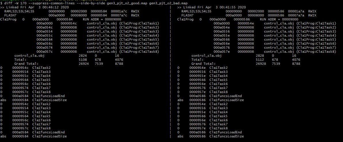

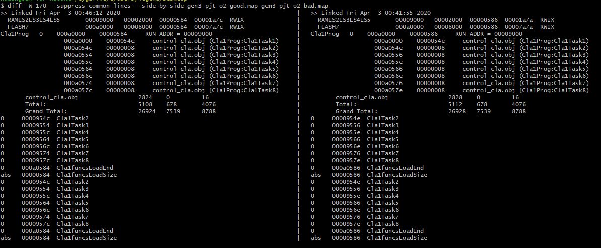

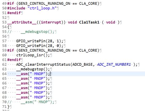

Running control algorithm CLA1 and using GPIO28 to confirm CLA task 1 is executing periodically.
When CLA code size is of a certain size, CLA-task1 runs.  But once I increase the code size by adding a single MNOP, the CLA-task1 no longer runs as GPIO28 does not toggle.
(See below, commented out MNOP)
CLA should not have any restrictions on task code size, other than available memory.
In the map files, once ClaTask1 goes from 0x54c to 0x54e.  Or Cla1Prog from 0x584 to 0x586  the CLA task does not run.

    Some things to check:
    1. Does the task run at least once?
    2. What do the CLA flags indicate when the task doesn't run?  Is the flag set? Is the task overflow flag set?  It may be that interrupts are coming in faster than it takes the interrupt to complete.
    3. If the task is being triggered by a peripheral, you can try triggering it with software and see if it runs.  That will point to whether the problem is in triggering the task or the task itself.
    Lori
  • Thank you for the fast response.
    Great suggestions.
    1. No the task does not run even once.
    2. When running ADCD4 EOC is configured to trigger CLA task1:
    CLA Regs: MIER=0xff, MIFR=0, MIOVF=0
    CPU1 Regs: IER=0x1401, IFR= 0, PIEIER1=0x5d, PIEIFR1=0x20, ADC4Regs: ADCINTSEL1N2=0x24, ADCINTFLG=0x1, ADCINTOVF=0x01
    Looks like I have an ADCINT1 overflow.
    3. I added a call to force the task to run in mainloop and it worked.  The CLA task starts to run periodically from the ADC EOC interrupt.
    Looks like have some timing issue with setting up interrupts / clearing flags.
    The code size issues must be a red herring that changed my timing when copying Cla1Prog from flash to memory.
    Thanks for the great suggestions, I will look into interrupts more and get back to this thread on my results.
  • I moved the cla_init() code to before the adc_init() code and everything worked fine.
