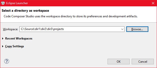

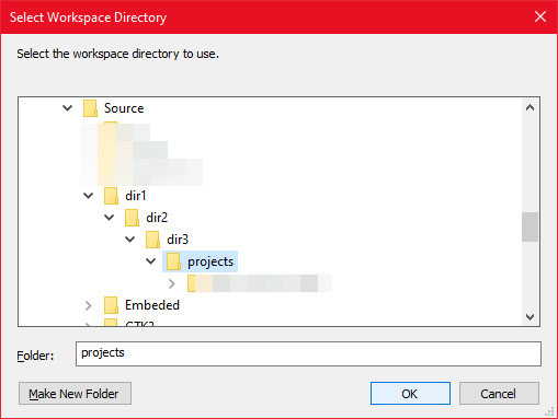

  • You can set the CCS workspace directory to be the folder that contains your source controlled project. For instance, if C:\Source\dir1\dir1\dir3\projects\ProjectName is the name of your project directory, then set the CCS workspace directory to be C:\Source\dir1\dir1\dir3\projects. Then go to the Project Import menu and set the search-directory to be the same directory. Make sure to uncheck "Copy projects into workspace". That should allow you to import the project.

  • Thank you, but this does not work.
    (By the way, I forgot to mention, I am using CCS7.  And the source control is MS VSS, which I cannot find a plugin that works)
    I should also add that is is a "Branch" where the folder name is NOT the same as the project name
    i..e. project  BigProject  is in a folder called BigProject-branch2-3
    I Manually created a folder of the example "dir1/dir2/dir3/project/ " names, so I can redact company info...
    (I manually moved the entire project folder out of my existing folder, to this one.  So it is in there all alone.)

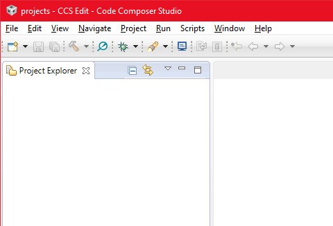

    And here is it...
    I open it, and naturally, it's empty

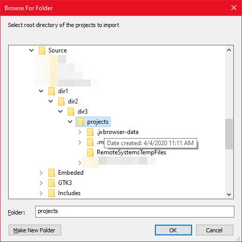

    Next up, do the "Import" as instructed:
    And it shows up as expected:
    (note, although redacted, the "Project" is the actual name of the project, the folder is the one that has the -Branch suffix )

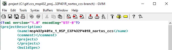

  • We don't use MS VSS but I tried to do something similar with CCS projects version controlled to Git. I get a similar error (not exact but close) if I physically rename a project directory (so the project directory name is different from the project name) using Windows Explorer, (ie) outside of the CCS environment.
    Since project details are stored in the workspace, I believe a directory name change that happens under the hood is throwing it off. If a project were instead renamed from inside CCS then the project directory is also correspondingly renamed and CCS/Eclipse would manage it all.

  • Christopher Weber said:
    So, the problem is you can't have a "branch" where the folder name differs from the project.  Meaning you can't have a "branch". The actual project name is buried somewhere in the CCS files.
    I'm not familiar with your source control software but in the Git integration with CCS, creating a branch does not rename the actual project directory name. Git just tracks information on which branch is checked out, etc. So it seems to be work a bit differently from your source control software.
    I tried to simulate your environment in one of my Git projects by doing the following:
    1) I used Git to rename one of the source controlled project directories. After this, the directory name was msp432p401x_1_MSP_EXP432P401R_nortos_ccs-branch, while the project name was still msp432p401x_1_MSP_EXP432P401R_nortos_ccs (as indicated by the  .project file below).
    2) Opened a CCS workspace in a directory different from the location of project
    3) Imported the project. Import completed without errors.
    4) Project still physically resides in the "branch" directory so any changes made to the sources will be saved there.
    Unfortunately I am unable to duplicate the behavior you see, so there isn't anything specific I can request to be fixed. I know that doesn't help your immediate situation or alleviate the issues you are facing, but I will continue to be on the look out for such issues and will report back if I have any additional information. Thank you for your patience and sorry for the inconvenience.
