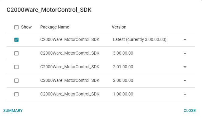

    BTW: The older motor control suite is not included in the folder tree or preferences. I'd put it up there too as the new SDK (FOC) is buggy, has motor current control issues. I reviewed SDK version 3 (FOC) code and no fixes for several reported issues were included in the manifest.
    Which specific version of SDK were you looking for? I do see a few older versions of the motor control SDK in Resource Explorer.
