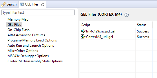

  • Hi Ki - Thanks for the reply.  Yes, "Reset the target on a connect" is disabled.  Still, when debugging, a reset occurs.  As far as I know, my project does not have a GEL file.  I'm on Windows, and from a command prompt from the root directory of my project I searched recursively by using "dir /s *.gel" and found no files.  I also searched all files for "OnTargetConnect" and "OnFileLoaded" and found nothing.  Any other ideas?
    After you start a debug session, check the GEL view to see if you have any GEL files are loaded:
  • Ah, okay, I wasn't aware of this at all.  Here's what I've got:
    Though, looking through both files, I'm not seeing anything that appears to be an issue.  The contents:

  • I don't see anything in the GEL files that would trigger a reset. Can you try starting a project-less debug session and see if a reset is triggered also?
