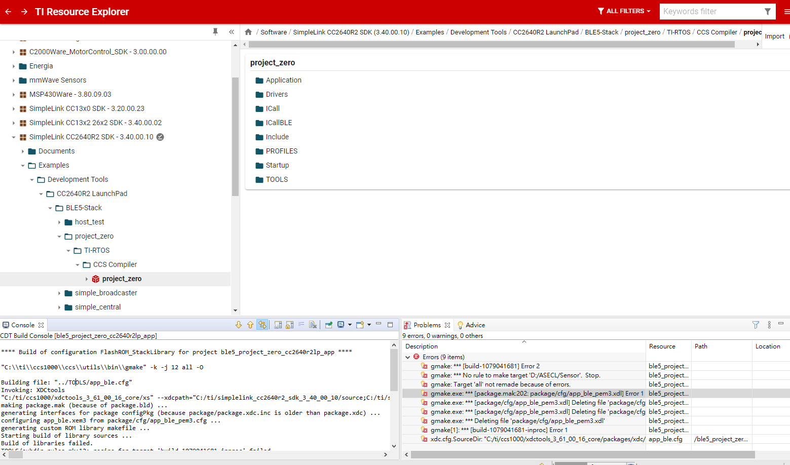

I got build errors when I build the project zero app in CCS 10 and CCS cloud IDE, please help to solved this issue.
The following is my development environment:
OS: Win10
TI EVB: LAUNCHXL-CC2640R2
SDK: SimpleLink 3.40.00.10
Code Composer Studio: 10.0.0.00010
**** Build of configuration FlashROM_StackLibrary for project ble5_project_zero_cc2640r2lp_app ****
"C:\\ti\\ccs1000\\ccs\\utils\\bin\\gmake" -k -j 12 all -O
Building file: "../TOOLS/app_ble.cfg"
Invoking: XDCtools
"C:/ti/ccs1000/xdctools_3_61_00_16_core/xs" --xdcpath="C:/ti/simplelink_cc2640r2_sdk_3_40_00_10/source;C:/ti/simplelink_cc2640r2_sdk_3_40_00_10/kernel/tirtos/packages;C:/ti/simplelink_cc2640r2_sdk_3_40_00_10/source/ti/ble5stack;" xdc.tools.configuro -o configPkg -t ti.targets.arm.elf.M3 -p ti.platforms.simplelink:CC2640R2F -r release -c "C:/ti/ccs1000/ccs/tools/compiler/ti-cgt-arm_20.2.0.LTS" --compileOptions "-mv7M4 --code_state=16 -me -O2 --opt_for_speed=0 --include_path=\"D:/ASECL/Sensor module/03_Datasheet/BT5_1-SOC/TI/workspace/ble5_project_zero_cc2640r2lp_app\" --include_path=\"D:/ASECL/Sensor module/03_Datasheet/BT5_1-SOC/TI/workspace/ble5_project_zero_cc2640r2lp_app/Application\" --include_path=\"D:/ASECL/Sensor module/03_Datasheet/BT5_1-SOC/TI/workspace/ble5_project_zero_cc2640r2lp_app/Startup\" --include_path=\"D:/ASECL/Sensor module/03_Datasheet/BT5_1-SOC/TI/workspace/ble5_project_zero_cc2640r2lp_app/PROFILES\" --include_path=\"D:/ASECL/Sensor module/03_Datasheet/BT5_1-SOC/TI/workspace/ble5_project_zero_cc2640r2lp_app/Include\" --include_path=\"C:/ti/simplelink_cc2640r2_sdk_3_40_00_10/examples/rtos/CC2640R2_LAUNCHXL/ble5stack/project_zero/src/extra\" --include_path=\"C:/ti/simplelink_cc2640r2_sdk_3_40_00_10/source/ti/ble5stack/controller/cc26xx/inc\" --include_path=\"C:/ti/simplelink_cc2640r2_sdk_3_40_00_10/source/ti/ble5stack/inc\" --include_path=\"C:/ti/simplelink_cc2640r2_sdk_3_40_00_10/source/ti/ble5stack/rom\" --include_path=\"C:/ti/simplelink_cc2640r2_sdk_3_40_00_10/source/ti/ble5stack/common/cc26xx\" --include_path=\"C:/ti/simplelink_cc2640r2_sdk_3_40_00_10/source/ti/ble5stack/icall/inc\" --include_path=\"C:/ti/simplelink_cc2640r2_sdk_3_40_00_10/source/ti/ble5stack/target\" --include_path=\"C:/ti/simplelink_cc2640r2_sdk_3_40_00_10/source/ti/ble5stack/hal/src/target/_common\" --include_path=\"C:/ti/simplelink_cc2640r2_sdk_3_40_00_10/source/ti/ble5stack/hal/src/target/_common/cc26xx\" --include_path=\"C:/ti/simplelink_cc2640r2_sdk_3_40_00_10/source/ti/ble5stack/hal/src/inc\" --include_path=\"C:/ti/simplelink_cc2640r2_sdk_3_40_00_10/source/ti/ble5stack/heapmgr\" --include_path=\"C:/ti/simplelink_cc2640r2_sdk_3_40_00_10/source/ti/ble5stack/icall/src/inc\" --include_path=\"C:/ti/simplelink_cc2640r2_sdk_3_40_00_10/source/ti/ble5stack/osal/src/inc\" --include_path=\"C:/ti/simplelink_cc2640r2_sdk_3_40_00_10/source/ti/ble5stack/services/src/saddr\" --include_path=\"C:/ti/simplelink_cc2640r2_sdk_3_40_00_10/source/ti/ble5stack/services/src/sdata\" --include_path=\"C:/ti/simplelink_cc2640r2_sdk_3_40_00_10/source/ti/devices/cc26x0r2\" --include_path=\"C:/ti/ccs1000/ccs/tools/compiler/ti-cgt-arm_20.2.0.LTS/include\" --define=DeviceFamily_CC26X0R2 --define=uartlog_FILE=\"\"\"\" --define=UARTLOG_ENABLE -g --c99 --gcc --diag_warning=225 --diag_wrap=off --display_error_number --gen_func_subsections=on --abi=eabi " "../TOOLS/app_ble.cfg"
making package.mak (because of package.bld) ...
generating interfaces for package configPkg (because package/package.xdc.inc is older than package.xdc) ...
configuring app_ble.xem3 from package/cfg/app_ble_pem3.cfg ...
generating custom ROM library makefile ...
Starting build of library sources ...
Build of libraries failed.
TOOLS/subdir_rules.mk:12: recipe for target 'build-1079041681-inproc' failed
gmake: D:/ASECL/Sensor: No such file or directory
gmake: *** No rule to make target 'D:/ASECL/Sensor'. Stop.
error: xdc.cfg.SourceDir: "C:/ti/ccs1000/xdctools_3_61_00_16_core/packages/xdc/cfg/SourceDir.xs", line 209: xdc.cfg.SourceDir : Build of generated source libraries failed: exit status = 2:
js: "C:/ti/ccs1000/xdctools_3_61_00_16_core/packages/xdc/cfg/Main.xs", line 160: Error: Configuration failed!
gmake.exe: *** [package.mak:202: package/cfg/app_ble_pem3.xdl] Error 1
gmake.exe: *** Deleting file 'package/cfg/app_ble_pem3.xdl'
gmake.exe: *** [package/cfg/app_ble_pem3.xdl] Deleting file 'package/cfg/app_ble_pem3.h'
gmake.exe: *** [package/cfg/app_ble_pem3.xdl] Deleting file 'package/cfg/app_ble_pem3.c'
js: "C:/ti/ccs1000/xdctools_3_61_00_16_core/packages/xdc/tools/Cmdr.xs", line 52: Error: xdc.tools.configuro: configuration failed due to earlier errors (status = 2); 'linker.cmd' deleted.
gmake[1]: *** [build-1079041681-inproc] Error 1
gmake: *** [build-1079041681] Error 2
TOOLS/subdir_rules.mk:9: recipe for target 'build-1079041681' failed
gmake: Target 'all' not remade because of errors.
**** Build Finished ****

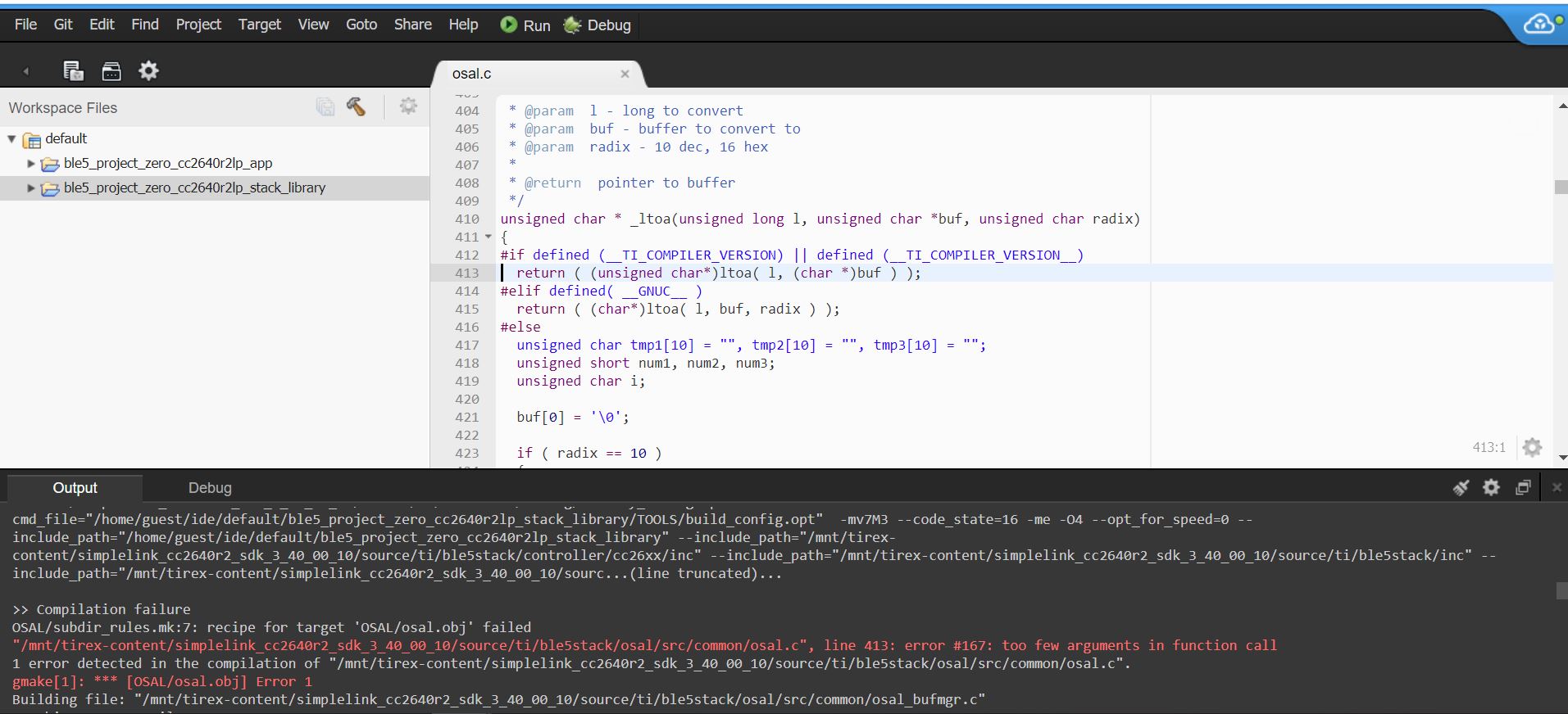

And CCS cloud IDE Compiler: TI v20.2.0.LTS
**** Build of configuration FlashROM_Library for project ble5_project_zero_cc2640r2lp_stack_library **** /mnt/ccs/ccs/utils/bin/gmake -k all /mnt/tirex-content/simplelink_cc2640r2_sdk_3_40_00_10/source/ti/ble5stack/../../../tools/ble5stack/lib_search/lib_search --opt /home/guest/ide/default/ble5_project_zero_cc2640r2lp_stack_library/TOOLS/build_config.opt --lib-dir /mnt/tirex-content/simplelink_cc2640r2_sdk_3_40_00_10/source/ti/ble5stack/blelib/cc26x0r2 --cmd /home/guest/ide/default/ble5_project_zero_cc2640r2lp_stack_library/FlashROM_Library/lib_linker.cmd --xml /mnt/tirex-content/simplelink_cc2640r2_sdk_3_40_00_10/source/ti/ble5stack/../../../tools/ble5stack/lib_search/lib_search.xml --sym-dir /mnt/tirex-content/simplelink_cc2640r2_sdk_3_40_00_10/source/ti/ble5stack/symbols/cc26x0r2 <<< Using library: /mnt/tirex-content/simplelink_cc2640r2_sdk_3_40_00_10/source/ti/ble5stack/blelib/cc26x0r2/ctrl/hci_pxxx.a >>> <<< Using library: /mnt/tirex-content/simplelink_cc2640r2_sdk_3_40_00_10/source/ti/ble5stack/blelib/cc26x0r2/ctrl/ll_pxxx.a >>> <<< Using library: /mnt/tirex-content/simplelink_cc2640r2_sdk_3_40_00_10/source/ti/ble5stack/blelib/cc26x0r2/hci_tl/hci_tl_none.a >>> <<< Using library: /mnt/tirex-content/simplelink_cc2640r2_sdk_3_40_00_10/source/ti/ble5stack/blelib/cc26x0r2/host/att_pxxx.a >>> <<< Using library: /mnt/tirex-content/simplelink_cc2640r2_sdk_3_40_00_10/source/ti/ble5stack/blelib/cc26x0r2/host/gap_pxxx.a >>> <<< Using library: /mnt/tirex-content/simplelink_cc2640r2_sdk_3_40_00_10/source/ti/ble5stack/blelib/cc26x0r2/host/gatt_pxxx.a >>> <<< Using library: /mnt/tirex-content/simplelink_cc2640r2_sdk_3_40_00_10/source/ti/ble5stack/blelib/cc26x0r2/host/l2cap_pxxx.a >>> <<< Using library: /mnt/tirex-content/simplelink_cc2640r2_sdk_3_40_00_10/source/ti/ble5stack/blelib/cc26x0r2/host/profiles_pxxx.a >>> <<< Using library: /mnt/tirex-content/simplelink_cc2640r2_sdk_3_40_00_10/source/ti/ble5stack/blelib/cc26x0r2/host/sm_pxxx.a >>> <<< Using library: /mnt/tirex-content/simplelink_cc2640r2_sdk_3_40_00_10/source/ti/ble5stack/blelib/cc26x0r2/host/smp_pxxx.a >>> <<< Not modifying lib_linker.cmd. Stack configurations have not changed. >>> <<< Using pxxx.symbols >>> Building file: "/mnt/tirex-content/simplelink_cc2640r2_sdk_3_40_00_10/source/ti/ble5stack/hal/src/common/hal_assert.c" Invoking: ARM Compiler "/mnt/ccs/ccs/tools/compiler/ti-cgt-arm_20.2.0.LTS/bin/armcl" --cmd_file="/home/guest/ide/default/ble5_project_zero_cc2640r2lp_stack_library/TOOLS/defines/ble5_project_zero_cc2640r2lp_stack_library_FlashROM_Library.opt" --cmd_file="/mnt/tirex-content/simplelink_cc2640r2_sdk_3_40_00_10/source/ti/ble5stack/config/build_components.opt" --cmd_file="/mnt/tirex-content/simplelink_cc2640r2_sdk_3_40_00_10/source/ti/ble5stack/config/factory_config.opt" --cmd_file="/home/guest/ide/default/ble5_project_zero_cc2640r2lp_stack_library/TOOLS/build_config.opt" -mv7M3 --code_state=16 -me -O4 --opt_for_speed=0 --include_path="/home/guest/ide/default/ble5_project_zero_cc2640r2lp_stack_library" --include_path="/mnt/tirex-content/simplelink_cc2640r2_sdk_3_40_00_10/source/ti/ble5stack/controller/cc26xx/inc" --include_path="/mnt/tirex-content/simplelink_cc2640r2_sdk_3_40_00_10/source/ti/ble5stack/inc" --include_path="/mnt/tirex-content/simplelink_cc2640r2_sdk_3_40_00_10/sourc...(line truncated)... Finished building: "/mnt/tirex-content/simplelink_cc2640r2_sdk_3_40_00_10/source/ti/ble5stack/hal/src/common/hal_assert.c" Building file: "/mnt/tirex-content/simplelink_cc2640r2_sdk_3_40_00_10/source/ti/ble5stack/hal/src/target/_common/hal_flash_wrapper.c" Invoking: ARM Compiler "/mnt/ccs/ccs/tools/compiler/ti-cgt-arm_20.2.0.LTS/bin/armcl" --cmd_file="/home/guest/ide/default/ble5_project_zero_cc2640r2lp_stack_library/TOOLS/defines/ble5_project_zero_cc2640r2lp_stack_library_FlashROM_Library.opt" --cmd_file="/mnt/tirex-content/simplelink_cc2640r2_sdk_3_40_00_10/source/ti/ble5stack/config/build_components.opt" --cmd_file="/mnt/tirex-content/simplelink_cc2640r2_sdk_3_40_00_10/source/ti/ble5stack/config/factory_config.opt" --cmd_file="/home/guest/ide/default/ble5_project_zero_cc2640r2lp_stack_library/TOOLS/build_config.opt" -mv7M3 --code_state=16 -me -O4 --opt_for_speed=0 --include_path="/home/guest/ide/default/ble5_project_zero_cc2640r2lp_stack_library" --include_path="/mnt/tirex-content/simplelink_cc2640r2_sdk_3_40_00_10/source/ti/ble5stack/controller/cc26xx/inc" --include_path="/mnt/tirex-content/simplelink_cc2640r2_sdk_3_40_00_10/source/ti/ble5stack/inc" --include_path="/mnt/tirex-content/simplelink_cc2640r2_sdk_3_40_00_10/sourc...(line truncated)... Finished building: "/mnt/tirex-content/simplelink_cc2640r2_sdk_3_40_00_10/source/ti/ble5stack/hal/src/target/_common/hal_flash_wrapper.c" Building file: "/mnt/tirex-content/simplelink_cc2640r2_sdk_3_40_00_10/source/ti/ble5stack/hal/src/target/_common/hal_rtc_wrapper.c" Invoking: ARM Compiler "/mnt/ccs/ccs/tools/compiler/ti-cgt-arm_20.2.0.LTS/bin/armcl" --cmd_file="/home/guest/ide/default/ble5_project_zero_cc2640r2lp_stack_library/TOOLS/defines/ble5_project_zero_cc2640r2lp_stack_library_FlashROM_Library.opt" --cmd_file="/mnt/tirex-content/simplelink_cc2640r2_sdk_3_40_00_10/source/ti/ble5stack/config/build_components.opt" --cmd_file="/mnt/tirex-content/simplelink_cc2640r2_sdk_3_40_00_10/source/ti/ble5stack/config/factory_config.opt" --cmd_file="/home/guest/ide/default/ble5_project_zero_cc2640r2lp_stack_library/TOOLS/build_config.opt" -mv7M3 --code_state=16 -me -O4 --opt_for_speed=0 --include_path="/home/guest/ide/default/ble5_project_zero_cc2640r2lp_stack_library" --include_path="/mnt/tirex-content/simplelink_cc2640r2_sdk_3_40_00_10/source/ti/ble5stack/controller/cc26xx/inc" --include_path="/mnt/tirex-content/simplelink_cc2640r2_sdk_3_40_00_10/source/ti/ble5stack/inc" --include_path="/mnt/tirex-content/simplelink_cc2640r2_sdk_3_40_00_10/sourc...(line truncated)... Finished building: "/mnt/tirex-content/simplelink_cc2640r2_sdk_3_40_00_10/source/ti/ble5stack/hal/src/target/_common/hal_rtc_wrapper.c" Building file: "/mnt/tirex-content/simplelink_cc2640r2_sdk_3_40_00_10/source/ti/ble5stack/hal/src/target/_common/hal_trng_wrapper.c" Invoking: ARM Compiler "/mnt/ccs/ccs/tools/compiler/ti-cgt-arm_20.2.0.LTS/bin/armcl" --cmd_file="/home/guest/ide/default/ble5_project_zero_cc2640r2lp_stack_library/TOOLS/defines/ble5_project_zero_cc2640r2lp_stack_library_FlashROM_Library.opt" --cmd_file="/mnt/tirex-content/simplelink_cc2640r2_sdk_3_40_00_10/source/ti/ble5stack/config/build_components.opt" --cmd_file="/mnt/tirex-content/simplelink_cc2640r2_sdk_3_40_00_10/source/ti/ble5stack/config/factory_config.opt" --cmd_file="/home/guest/ide/default/ble5_project_zero_cc2640r2lp_stack_library/TOOLS/build_config.opt" -mv7M3 --code_state=16 -me -O4 --opt_for_speed=0 --include_path="/home/guest/ide/default/ble5_project_zero_cc2640r2lp_stack_library" --include_path="/mnt/tirex-content/simplelink_cc2640r2_sdk_3_40_00_10/source/ti/ble5stack/controller/cc26xx/inc" --include_path="/mnt/tirex-content/simplelink_cc2640r2_sdk_3_40_00_10/source/ti/ble5stack/inc" --include_path="/mnt/tirex-content/simplelink_cc2640r2_sdk_3_40_00_10/sourc...(line truncated)... Finished building: "/mnt/tirex-content/simplelink_cc2640r2_sdk_3_40_00_10/source/ti/ble5stack/hal/src/target/_common/hal_trng_wrapper.c" Building file: "/mnt/tirex-content/simplelink_cc2640r2_sdk_3_40_00_10/source/ti/ble5stack/hal/src/target/_common/cc26xx/mb_patch.c" Invoking: ARM Compiler "/mnt/ccs/ccs/tools/compiler/ti-cgt-arm_20.2.0.LTS/bin/armcl" --cmd_file="/home/guest/ide/default/ble5_project_zero_cc2640r2lp_stack_library/TOOLS/defines/ble5_project_zero_cc2640r2lp_stack_library_FlashROM_Library.opt" --cmd_file="/mnt/tirex-content/simplelink_cc2640r2_sdk_3_40_00_10/source/ti/ble5stack/config/build_components.opt" --cmd_file="/mnt/tirex-content/simplelink_cc2640r2_sdk_3_40_00_10/source/ti/ble5stack/config/factory_config.opt" --cmd_file="/home/guest/ide/default/ble5_project_zero_cc2640r2lp_stack_library/TOOLS/build_config.opt" -mv7M3 --code_state=16 -me -O4 --opt_for_speed=0 --include_path="/home/guest/ide/default/ble5_project_zero_cc2640r2lp_stack_library" --include_path="/mnt/tirex-content/simplelink_cc2640r2_sdk_3_40_00_10/source/ti/ble5stack/controller/cc26xx/inc" --include_path="/mnt/tirex-content/simplelink_cc2640r2_sdk_3_40_00_10/source/ti/ble5stack/inc" --include_path="/mnt/tirex-content/simplelink_cc2640r2_sdk_3_40_00_10/sourc...(line truncated)... Finished building: "/mnt/tirex-content/simplelink_cc2640r2_sdk_3_40_00_10/source/ti/ble5stack/hal/src/target/_common/cc26xx/mb_patch.c" Building file: "/mnt/tirex-content/simplelink_cc2640r2_sdk_3_40_00_10/source/ti/ble5stack/host/gatt_uuid.c" Invoking: ARM Compiler "/mnt/ccs/ccs/tools/compiler/ti-cgt-arm_20.2.0.LTS/bin/armcl" --cmd_file="/home/guest/ide/default/ble5_project_zero_cc2640r2lp_stack_library/TOOLS/defines/ble5_project_zero_cc2640r2lp_stack_library_FlashROM_Library.opt" --cmd_file="/mnt/tirex-content/simplelink_cc2640r2_sdk_3_40_00_10/source/ti/ble5stack/config/build_components.opt" --cmd_file="/mnt/tirex-content/simplelink_cc2640r2_sdk_3_40_00_10/source/ti/ble5stack/config/factory_config.opt" --cmd_file="/home/guest/ide/default/ble5_project_zero_cc2640r2lp_stack_library/TOOLS/build_config.opt" -mv7M3 --code_state=16 -me -O4 --opt_for_speed=0 --include_path="/home/guest/ide/default/ble5_project_zero_cc2640r2lp_stack_library" --include_path="/mnt/tirex-content/simplelink_cc2640r2_sdk_3_40_00_10/source/ti/ble5stack/controller/cc26xx/inc" --include_path="/mnt/tirex-content/simplelink_cc2640r2_sdk_3_40_00_10/source/ti/ble5stack/inc" --include_path="/mnt/tirex-content/simplelink_cc2640r2_sdk_3_40_00_10/sourc...(line truncated)... Finished building: "/mnt/tirex-content/simplelink_cc2640r2_sdk_3_40_00_10/source/ti/ble5stack/host/gatt_uuid.c" Building file: "/mnt/tirex-content/simplelink_cc2640r2_sdk_3_40_00_10/source/ti/ble5stack/icall/stack/ble_dispatch_JT.c" Invoking: ARM Compiler "/mnt/ccs/ccs/tools/compiler/ti-cgt-arm_20.2.0.LTS/bin/armcl" --cmd_file="/home/guest/ide/default/ble5_project_zero_cc2640r2lp_stack_library/TOOLS/defines/ble5_project_zero_cc2640r2lp_stack_library_FlashROM_Library.opt" --cmd_file="/mnt/tirex-content/simplelink_cc2640r2_sdk_3_40_00_10/source/ti/ble5stack/config/build_components.opt" --cmd_file="/mnt/tirex-content/simplelink_cc2640r2_sdk_3_40_00_10/source/ti/ble5stack/config/factory_config.opt" --cmd_file="/home/guest/ide/default/ble5_project_zero_cc2640r2lp_stack_library/TOOLS/build_config.opt" -mv7M3 --code_state=16 -me -O4 --opt_for_speed=0 --include_path="/home/guest/ide/default/ble5_project_zero_cc2640r2lp_stack_library" --include_path="/mnt/tirex-content/simplelink_cc2640r2_sdk_3_40_00_10/source/ti/ble5stack/controller/cc26xx/inc" --include_path="/mnt/tirex-content/simplelink_cc2640r2_sdk_3_40_00_10/source/ti/ble5stack/inc" --include_path="/mnt/tirex-content/simplelink_cc2640r2_sdk_3_40_00_10/sourc...(line truncated)... Finished building: "/mnt/tirex-content/simplelink_cc2640r2_sdk_3_40_00_10/source/ti/ble5stack/icall/stack/ble_dispatch_JT.c" Building file: "/mnt/tirex-content/simplelink_cc2640r2_sdk_3_40_00_10/source/ti/ble5stack/icall/stack/ble_dispatch_lite.c" Invoking: ARM Compiler "/mnt/ccs/ccs/tools/compiler/ti-cgt-arm_20.2.0.LTS/bin/armcl" --cmd_file="/home/guest/ide/default/ble5_project_zero_cc2640r2lp_stack_library/TOOLS/defines/ble5_project_zero_cc2640r2lp_stack_library_FlashROM_Library.opt" --cmd_file="/mnt/tirex-content/simplelink_cc2640r2_sdk_3_40_00_10/source/ti/ble5stack/config/build_components.opt" --cmd_file="/mnt/tirex-content/simplelink_cc2640r2_sdk_3_40_00_10/source/ti/ble5stack/config/factory_config.opt" --cmd_file="/home/guest/ide/default/ble5_project_zero_cc2640r2lp_stack_library/TOOLS/build_config.opt" -mv7M3 --code_state=16 -me -O4 --opt_for_speed=0 --include_path="/home/guest/ide/default/ble5_project_zero_cc2640r2lp_stack_library" --include_path="/mnt/tirex-content/simplelink_cc2640r2_sdk_3_40_00_10/source/ti/ble5stack/controller/cc26xx/inc" --include_path="/mnt/tirex-content/simplelink_cc2640r2_sdk_3_40_00_10/source/ti/ble5stack/inc" --include_path="/mnt/tirex-content/simplelink_cc2640r2_sdk_3_40_00_10/sourc...(line truncated)... Finished building: "/mnt/tirex-content/simplelink_cc2640r2_sdk_3_40_00_10/source/ti/ble5stack/icall/stack/ble_dispatch_lite.c" Building file: "/mnt/tirex-content/simplelink_cc2640r2_sdk_3_40_00_10/source/ti/ble5stack/icall/src/icall_lite_translation.c" Invoking: ARM Compiler "/mnt/ccs/ccs/tools/compiler/ti-cgt-arm_20.2.0.LTS/bin/armcl" --cmd_file="/home/guest/ide/default/ble5_project_zero_cc2640r2lp_stack_library/TOOLS/defines/ble5_project_zero_cc2640r2lp_stack_library_FlashROM_Library.opt" --cmd_file="/mnt/tirex-content/simplelink_cc2640r2_sdk_3_40_00_10/source/ti/ble5stack/config/build_components.opt" --cmd_file="/mnt/tirex-content/simplelink_cc2640r2_sdk_3_40_00_10/source/ti/ble5stack/config/factory_config.opt" --cmd_file="/home/guest/ide/default/ble5_project_zero_cc2640r2lp_stack_library/TOOLS/build_config.opt" -mv7M3 --code_state=16 -me -O4 --opt_for_speed=0 --include_path="/home/guest/ide/default/ble5_project_zero_cc2640r2lp_stack_library" --include_path="/mnt/tirex-content/simplelink_cc2640r2_sdk_3_40_00_10/source/ti/ble5stack/controller/cc26xx/inc" --include_path="/mnt/tirex-content/simplelink_cc2640r2_sdk_3_40_00_10/source/ti/ble5stack/inc" --include_path="/mnt/tirex-content/simplelink_cc2640r2_sdk_3_40_00_10/sourc...(line truncated)... Finished building: "/mnt/tirex-content/simplelink_cc2640r2_sdk_3_40_00_10/source/ti/ble5stack/icall/src/icall_lite_translation.c" Building file: "/mnt/tirex-content/simplelink_cc2640r2_sdk_3_40_00_10/source/ti/ble5stack/common/cc26xx/npi/stack/npi.c" Invoking: ARM Compiler "/mnt/ccs/ccs/tools/compiler/ti-cgt-arm_20.2.0.LTS/bin/armcl" --cmd_file="/home/guest/ide/default/ble5_project_zero_cc2640r2lp_stack_library/TOOLS/defines/ble5_project_zero_cc2640r2lp_stack_library_FlashROM_Library.opt" --cmd_file="/mnt/tirex-content/simplelink_cc2640r2_sdk_3_40_00_10/source/ti/ble5stack/config/build_components.opt" --cmd_file="/mnt/tirex-content/simplelink_cc2640r2_sdk_3_40_00_10/source/ti/ble5stack/config/factory_config.opt" --cmd_file="/home/guest/ide/default/ble5_project_zero_cc2640r2lp_stack_library/TOOLS/build_config.opt" -mv7M3 --code_state=16 -me -O4 --opt_for_speed=0 --include_path="/home/guest/ide/default/ble5_project_zero_cc2640r2lp_stack_library" --include_path="/mnt/tirex-content/simplelink_cc2640r2_sdk_3_40_00_10/source/ti/ble5stack/controller/cc26xx/inc" --include_path="/mnt/tirex-content/simplelink_cc2640r2_sdk_3_40_00_10/source/ti/ble5stack/inc" --include_path="/mnt/tirex-content/simplelink_cc2640r2_sdk_3_40_00_10/sourc...(line truncated)... Finished building: "/mnt/tirex-content/simplelink_cc2640r2_sdk_3_40_00_10/source/ti/ble5stack/common/cc26xx/npi/stack/npi.c" Building file: "/mnt/tirex-content/simplelink_cc2640r2_sdk_3_40_00_10/source/ti/ble5stack/osal/src/common/osal.c" Invoking: ARM Compiler "/mnt/ccs/ccs/tools/compiler/ti-cgt-arm_20.2.0.LTS/bin/armcl" --cmd_file="/home/guest/ide/default/ble5_project_zero_cc2640r2lp_stack_library/TOOLS/defines/ble5_project_zero_cc2640r2lp_stack_library_FlashROM_Library.opt" --cmd_file="/mnt/tirex-content/simplelink_cc2640r2_sdk_3_40_00_10/source/ti/ble5stack/config/build_components.opt" --cmd_file="/mnt/tirex-content/simplelink_cc2640r2_sdk_3_40_00_10/source/ti/ble5stack/config/factory_config.opt" --cmd_file="/home/guest/ide/default/ble5_project_zero_cc2640r2lp_stack_library/TOOLS/build_config.opt" -mv7M3 --code_state=16 -me -O4 --opt_for_speed=0 --include_path="/home/guest/ide/default/ble5_project_zero_cc2640r2lp_stack_library" --include_path="/mnt/tirex-content/simplelink_cc2640r2_sdk_3_40_00_10/source/ti/ble5stack/controller/cc26xx/inc" --include_path="/mnt/tirex-content/simplelink_cc2640r2_sdk_3_40_00_10/source/ti/ble5stack/inc" --include_path="/mnt/tirex-content/simplelink_cc2640r2_sdk_3_40_00_10/sourc...(line truncated)... >> Compilation failure OSAL/subdir_rules.mk:7: recipe for target 'OSAL/osal.obj' failed "/mnt/tirex-content/simplelink_cc2640r2_sdk_3_40_00_10/source/ti/ble5stack/osal/src/common/osal.c", line 413: error #167: too few arguments in function call 1 error detected in the compilation of "/mnt/tirex-content/simplelink_cc2640r2_sdk_3_40_00_10/source/ti/ble5stack/osal/src/common/osal.c". gmake[1]: *** [OSAL/osal.obj] Error 1 Building file: "/mnt/tirex-content/simplelink_cc2640r2_sdk_3_40_00_10/source/ti/ble5stack/osal/src/common/osal_bufmgr.c" Invoking: ARM Compiler "/mnt/ccs/ccs/tools/compiler/ti-cgt-arm_20.2.0.LTS/bin/armcl" --cmd_file="/home/guest/ide/default/ble5_project_zero_cc2640r2lp_stack_library/TOOLS/defines/ble5_project_zero_cc2640r2lp_stack_library_FlashROM_Library.opt" --cmd_file="/mnt/tirex-content/simplelink_cc2640r2_sdk_3_40_00_10/source/ti/ble5stack/config/build_components.opt" --cmd_file="/mnt/tirex-content/simplelink_cc2640r2_sdk_3_40_00_10/source/ti/ble5stack/config/factory_config.opt" --cmd_file="/home/guest/ide/default/ble5_project_zero_cc2640r2lp_stack_library/TOOLS/build_config.opt" -mv7M3 --code_state=16 -me -O4 --opt_for_speed=0 --include_path="/home/guest/ide/default/ble5_project_zero_cc2640r2lp_stack_library" --include_path="/mnt/tirex-content/simplelink_cc2640r2_sdk_3_40_00_10/source/ti/ble5stack/controller/cc26xx/inc" --include_path="/mnt/tirex-content/simplelink_cc2640r2_sdk_3_40_00_10/source/ti/ble5stack/inc" --include_path="/mnt/tirex-content/simplelink_cc2640r2_sdk_3_40_00_10/sourc...(line truncated)... Finished building: "/mnt/tirex-content/simplelink_cc2640r2_sdk_3_40_00_10/source/ti/ble5stack/osal/src/common/osal_bufmgr.c" Building file: "/mnt/tirex-content/simplelink_cc2640r2_sdk_3_40_00_10/source/ti/ble5stack/osal/src/common/osal_cbtimer.c" Invoking: ARM Compiler "/mnt/ccs/ccs/tools/compiler/ti-cgt-arm_20.2.0.LTS/bin/armcl" --cmd_file="/home/guest/ide/default/ble5_project_zero_cc2640r2lp_stack_library/TOOLS/defines/ble5_project_zero_cc2640r2lp_stack_library_FlashROM_Library.opt" --cmd_file="/mnt/tirex-content/simplelink_cc2640r2_sdk_3_40_00_10/source/ti/ble5stack/config/build_components.opt" --cmd_file="/mnt/tirex-content/simplelink_cc2640r2_sdk_3_40_00_10/source/ti/ble5stack/config/factory_config.opt" --cmd_file="/home/guest/ide/default/ble5_project_zero_cc2640r2lp_stack_library/TOOLS/build_config.opt" -mv7M3 --code_state=16 -me -O4 --opt_for_speed=0 --include_path="/home/guest/ide/default/ble5_project_zero_cc2640r2lp_stack_library" --include_path="/mnt/tirex-content/simplelink_cc2640r2_sdk_3_40_00_10/source/ti/ble5stack/controller/cc26xx/inc" --include_path="/mnt/tirex-content/simplelink_cc2640r2_sdk_3_40_00_10/source/ti/ble5stack/inc" --include_path="/mnt/tirex-content/simplelink_cc2640r2_sdk_3_40_00_10/sourc...(line truncated)... Finished building: "/mnt/tirex-content/simplelink_cc2640r2_sdk_3_40_00_10/source/ti/ble5stack/osal/src/common/osal_cbtimer.c" Building file: "/mnt/tirex-content/simplelink_cc2640r2_sdk_3_40_00_10/source/ti/ble5stack/osal/src/common/osal_clock.c" Invoking: ARM Compiler "/mnt/ccs/ccs/tools/compiler/ti-cgt-arm_20.2.0.LTS/bin/armcl" --cmd_file="/home/guest/ide/default/ble5_project_zero_cc2640r2lp_stack_library/TOOLS/defines/ble5_project_zero_cc2640r2lp_stack_library_FlashROM_Library.opt" --cmd_file="/mnt/tirex-content/simplelink_cc2640r2_sdk_3_40_00_10/source/ti/ble5stack/config/build_components.opt" --cmd_file="/mnt/tirex-content/simplelink_cc2640r2_sdk_3_40_00_10/source/ti/ble5stack/config/factory_config.opt" --cmd_file="/home/guest/ide/default/ble5_project_zero_cc2640r2lp_stack_library/TOOLS/build_config.opt" -mv7M3 --code_state=16 -me -O4 --opt_for_speed=0 --include_path="/home/guest/ide/default/ble5_project_zero_cc2640r2lp_stack_library" --include_path="/mnt/tirex-content/simplelink_cc2640r2_sdk_3_40_00_10/source/ti/ble5stack/controller/cc26xx/inc" --include_path="/mnt/tirex-content/simplelink_cc2640r2_sdk_3_40_00_10/source/ti/ble5stack/inc" --include_path="/mnt/tirex-content/simplelink_cc2640r2_sdk_3_40_00_10/sourc...(line truncated)... Finished building: "/mnt/tirex-content/simplelink_cc2640r2_sdk_3_40_00_10/source/ti/ble5stack/osal/src/common/osal_clock.c" Building file: "/mnt/tirex-content/simplelink_cc2640r2_sdk_3_40_00_10/source/ti/ble5stack/osal/src/common/osal_list.c" Invoking: ARM Compiler "/mnt/ccs/ccs/tools/compiler/ti-cgt-arm_20.2.0.LTS/bin/armcl" --cmd_file="/home/guest/ide/default/ble5_project_zero_cc2640r2lp_stack_library/TOOLS/defines/ble5_project_zero_cc2640r2lp_stack_library_FlashROM_Library.opt" --cmd_file="/mnt/tirex-content/simplelink_cc2640r2_sdk_3_40_00_10/source/ti/ble5stack/config/build_components.opt" --cmd_file="/mnt/tirex-content/simplelink_cc2640r2_sdk_3_40_00_10/source/ti/ble5stack/config/factory_config.opt" --cmd_file="/home/guest/ide/default/ble5_project_zero_cc2640r2lp_stack_library/TOOLS/build_config.opt" -mv7M3 --code_state=16 -me -O4 --opt_for_speed=0 --include_path="/home/guest/ide/default/ble5_project_zero_cc2640r2lp_stack_library" --include_path="/mnt/tirex-content/simplelink_cc2640r2_sdk_3_40_00_10/source/ti/ble5stack/controller/cc26xx/inc" --include_path="/mnt/tirex-content/simplelink_cc2640r2_sdk_3_40_00_10/source/ti/ble5stack/inc" --include_path="/mnt/tirex-content/simplelink_cc2640r2_sdk_3_40_00_10/sourc...(line truncated)... Finished building: "/mnt/tirex-content/simplelink_cc2640r2_sdk_3_40_00_10/source/ti/ble5stack/osal/src/common/osal_list.c" Building file: "/mnt/tirex-content/simplelink_cc2640r2_sdk_3_40_00_10/source/ti/ble5stack/osal/src/common/osal_memory_icall.c" Invoking: ARM Compiler "/mnt/ccs/ccs/tools/compiler/ti-cgt-arm_20.2.0.LTS/bin/armcl" --cmd_file="/home/guest/ide/default/ble5_project_zero_cc2640r2lp_stack_library/TOOLS/defines/ble5_project_zero_cc2640r2lp_stack_library_FlashROM_Library.opt" --cmd_file="/mnt/tirex-content/simplelink_cc2640r2_sdk_3_40_00_10/source/ti/ble5stack/config/build_components.opt" --cmd_file="/mnt/tirex-content/simplelink_cc2640r2_sdk_3_40_00_10/source/ti/ble5stack/config/factory_config.opt" --cmd_file="/home/guest/ide/default/ble5_project_zero_cc2640r2lp_stack_library/TOOLS/build_config.opt" -mv7M3 --code_state=16 -me -O4 --opt_for_speed=0 --include_path="/home/guest/ide/default/ble5_project_zero_cc2640r2lp_stack_library" --include_path="/mnt/tirex-content/simplelink_cc2640r2_sdk_3_40_00_10/source/ti/ble5stack/controller/cc26xx/inc" --include_path="/mnt/tirex-content/simplelink_cc2640r2_sdk_3_40_00_10/source/ti/ble5stack/inc" --include_path="/mnt/tirex-content/simplelink_cc2640r2_sdk_3_40_00_10/sourc...(line truncated)... Finished building: "/mnt/tirex-content/simplelink_cc2640r2_sdk_3_40_00_10/source/ti/ble5stack/osal/src/common/osal_memory_icall.c" Building file: "/mnt/tirex-content/simplelink_cc2640r2_sdk_3_40_00_10/source/ti/ble5stack/osal/src/common/osal_pwrmgr.c" Invoking: ARM Compiler "/mnt/ccs/ccs/tools/compiler/ti-cgt-arm_20.2.0.LTS/bin/armcl" --cmd_file="/home/guest/ide/default/ble5_project_zero_cc2640r2lp_stack_library/TOOLS/defines/ble5_project_zero_cc2640r2lp_stack_library_FlashROM_Library.opt" --cmd_file="/mnt/tirex-content/simplelink_cc2640r2_sdk_3_40_00_10/source/ti/ble5stack/config/build_components.opt" --cmd_file="/mnt/tirex-content/simplelink_cc2640r2_sdk_3_40_00_10/source/ti/ble5stack/config/factory_config.opt" --cmd_file="/home/guest/ide/default/ble5_project_zero_cc2640r2lp_stack_library/TOOLS/build_config.opt" -mv7M3 --code_state=16 -me -O4 --opt_for_speed=0 --include_path="/home/guest/ide/default/ble5_project_zero_cc2640r2lp_stack_library" --include_path="/mnt/tirex-content/simplelink_cc2640r2_sdk_3_40_00_10/source/ti/ble5stack/controller/cc26xx/inc" --include_path="/mnt/tirex-content/simplelink_cc2640r2_sdk_3_40_00_10/source/ti/ble5stack/inc" --include_path="/mnt/tirex-content/simplelink_cc2640r2_sdk_3_40_00_10/sourc...(line truncated)... Finished building: "/mnt/tirex-content/simplelink_cc2640r2_sdk_3_40_00_10/source/ti/ble5stack/osal/src/common/osal_pwrmgr.c" Building file: "/mnt/tirex-content/simplelink_cc2640r2_sdk_3_40_00_10/source/ti/ble5stack/osal/src/mcu/cc26xx/osal_snv_wrapper.c" Invoking: ARM Compiler "/mnt/ccs/ccs/tools/compiler/ti-cgt-arm_20.2.0.LTS/bin/armcl" --cmd_file="/home/guest/ide/default/ble5_project_zero_cc2640r2lp_stack_library/TOOLS/defines/ble5_project_zero_cc2640r2lp_stack_library_FlashROM_Library.opt" --cmd_file="/mnt/tirex-content/simplelink_cc2640r2_sdk_3_40_00_10/source/ti/ble5stack/config/build_components.opt" --cmd_file="/mnt/tirex-content/simplelink_cc2640r2_sdk_3_40_00_10/source/ti/ble5stack/config/factory_config.opt" --cmd_file="/home/guest/ide/default/ble5_project_zero_cc2640r2lp_stack_library/TOOLS/build_config.opt" -mv7M3 --code_state=16 -me -O4 --opt_for_speed=0 --include_path="/home/guest/ide/default/ble5_project_zero_cc2640r2lp_stack_library" --include_path="/mnt/tirex-content/simplelink_cc2640r2_sdk_3_40_00_10/source/ti/ble5stack/controller/cc26xx/inc" --include_path="/mnt/tirex-content/simplelink_cc2640r2_sdk_3_40_00_10/source/ti/ble5stack/inc" --include_path="/mnt/tirex-content/simplelink_cc2640r2_sdk_3_40_00_10/sourc...(line truncated)... Finished building: "/mnt/tirex-content/simplelink_cc2640r2_sdk_3_40_00_10/source/ti/ble5stack/osal/src/mcu/cc26xx/osal_snv_wrapper.c" Building file: "/mnt/tirex-content/simplelink_cc2640r2_sdk_3_40_00_10/source/ti/ble5stack/osal/src/common/osal_timers.c" Invoking: ARM Compiler "/mnt/ccs/ccs/tools/compiler/ti-cgt-arm_20.2.0.LTS/bin/armcl" --cmd_file="/home/guest/ide/default/ble5_project_zero_cc2640r2lp_stack_library/TOOLS/defines/ble5_project_zero_cc2640r2lp_stack_library_FlashROM_Library.opt" --cmd_file="/mnt/tirex-content/simplelink_cc2640r2_sdk_3_40_00_10/source/ti/ble5stack/config/build_components.opt" --cmd_file="/mnt/tirex-content/simplelink_cc2640r2_sdk_3_40_00_10/source/ti/ble5stack/config/factory_config.opt" --cmd_file="/home/guest/ide/default/ble5_project_zero_cc2640r2lp_stack_library/TOOLS/build_config.opt" -mv7M3 --code_state=16 -me -O4 --opt_for_speed=0 --include_path="/home/guest/ide/default/ble5_project_zero_cc2640r2lp_stack_library" --include_path="/mnt/tirex-content/simplelink_cc2640r2_sdk_3_40_00_10/source/ti/ble5stack/controller/cc26xx/inc" --include_path="/mnt/tirex-content/simplelink_cc2640r2_sdk_3_40_00_10/source/ti/ble5stack/inc" --include_path="/mnt/tirex-content/simplelink_cc2640r2_sdk_3_40_00_10/sourc...(line truncated)... Finished building: "/mnt/tirex-content/simplelink_cc2640r2_sdk_3_40_00_10/source/ti/ble5stack/osal/src/common/osal_timers.c" Building file: "/mnt/tirex-content/simplelink_cc2640r2_sdk_3_40_00_10/source/ti/ble5stack/host/gap.c" Invoking: ARM Compiler "/mnt/ccs/ccs/tools/compiler/ti-cgt-arm_20.2.0.LTS/bin/armcl" --cmd_file="/home/guest/ide/default/ble5_project_zero_cc2640r2lp_stack_library/TOOLS/defines/ble5_project_zero_cc2640r2lp_stack_library_FlashROM_Library.opt" --cmd_file="/mnt/tirex-content/simplelink_cc2640r2_sdk_3_40_00_10/source/ti/ble5stack/config/build_components.opt" --cmd_file="/mnt/tirex-content/simplelink_cc2640r2_sdk_3_40_00_10/source/ti/ble5stack/config/factory_config.opt" --cmd_file="/home/guest/ide/default/ble5_project_zero_cc2640r2lp_stack_library/TOOLS/build_config.opt" -mv7M3 --code_state=16 -me -O4 --opt_for_speed=0 --include_path="/home/guest/ide/default/ble5_project_zero_cc2640r2lp_stack_library" --include_path="/mnt/tirex-content/simplelink_cc2640r2_sdk_3_40_00_10/source/ti/ble5stack/controller/cc26xx/inc" --include_path="/mnt/tirex-content/simplelink_cc2640r2_sdk_3_40_00_10/source/ti/ble5stack/inc" --include_path="/mnt/tirex-content/simplelink_cc2640r2_sdk_3_40_00_10/sourc...(line truncated)... Finished building: "/mnt/tirex-content/simplelink_cc2640r2_sdk_3_40_00_10/source/ti/ble5stack/host/gap.c" Building file: "/mnt/tirex-content/simplelink_cc2640r2_sdk_3_40_00_10/source/ti/ble5stack/host/gapbondmgr.c" Invoking: ARM Compiler "/mnt/ccs/ccs/tools/compiler/ti-cgt-arm_20.2.0.LTS/bin/armcl" --cmd_file="/home/guest/ide/default/ble5_project_zero_cc2640r2lp_stack_library/TOOLS/defines/ble5_project_zero_cc2640r2lp_stack_library_FlashROM_Library.opt" --cmd_file="/mnt/tirex-content/simplelink_cc2640r2_sdk_3_40_00_10/source/ti/ble5stack/config/build_components.opt" --cmd_file="/mnt/tirex-content/simplelink_cc2640r2_sdk_3_40_00_10/source/ti/ble5stack/config/factory_config.opt" --cmd_file="/home/guest/ide/default/ble5_project_zero_cc2640r2lp_stack_library/TOOLS/build_config.opt" -mv7M3 --code_state=16 -me -O4 --opt_for_speed=0 --include_path="/home/guest/ide/default/ble5_project_zero_cc2640r2lp_stack_library" --include_path="/mnt/tirex-content/simplelink_cc2640r2_sdk_3_40_00_10/source/ti/ble5stack/controller/cc26xx/inc" --include_path="/mnt/tirex-content/simplelink_cc2640r2_sdk_3_40_00_10/source/ti/ble5stack/inc" --include_path="/mnt/tirex-content/simplelink_cc2640r2_sdk_3_40_00_10/sourc...(line truncated)... Finished building: "/mnt/tirex-content/simplelink_cc2640r2_sdk_3_40_00_10/source/ti/ble5stack/host/gapbondmgr.c" Building file: "/mnt/tirex-content/simplelink_cc2640r2_sdk_3_40_00_10/source/ti/ble5stack/host/gattservapp_util.c" Invoking: ARM Compiler "/mnt/ccs/ccs/tools/compiler/ti-cgt-arm_20.2.0.LTS/bin/armcl" --cmd_file="/home/guest/ide/default/ble5_project_zero_cc2640r2lp_stack_library/TOOLS/defines/ble5_project_zero_cc2640r2lp_stack_library_FlashROM_Library.opt" --cmd_file="/mnt/tirex-content/simplelink_cc2640r2_sdk_3_40_00_10/source/ti/ble5stack/config/build_components.opt" --cmd_file="/mnt/tirex-content/simplelink_cc2640r2_sdk_3_40_00_10/source/ti/ble5stack/config/factory_config.opt" --cmd_file="/home/guest/ide/default/ble5_project_zero_cc2640r2lp_stack_library/TOOLS/build_config.opt" -mv7M3 --code_state=16 -me -O4 --opt_for_speed=0 --include_path="/home/guest/ide/default/ble5_project_zero_cc2640r2lp_stack_library" --include_path="/mnt/tirex-content/simplelink_cc2640r2_sdk_3_40_00_10/source/ti/ble5stack/controller/cc26xx/inc" --include_path="/mnt/tirex-content/simplelink_cc2640r2_sdk_3_40_00_10/source/ti/ble5stack/inc" --include_path="/mnt/tirex-content/simplelink_cc2640r2_sdk_3_40_00_10/sourc...(line truncated)... Finished building: "/mnt/tirex-content/simplelink_cc2640r2_sdk_3_40_00_10/source/ti/ble5stack/host/gattservapp_util.c" Building file: "/mnt/tirex-content/simplelink_cc2640r2_sdk_3_40_00_10/source/ti/ble5stack/host/sm_ecc.c" Invoking: ARM Compiler "/mnt/ccs/ccs/tools/compiler/ti-cgt-arm_20.2.0.LTS/bin/armcl" --cmd_file="/home/guest/ide/default/ble5_project_zero_cc2640r2lp_stack_library/TOOLS/defines/ble5_project_zero_cc2640r2lp_stack_library_FlashROM_Library.opt" --cmd_file="/mnt/tirex-content/simplelink_cc2640r2_sdk_3_40_00_10/source/ti/ble5stack/config/build_components.opt" --cmd_file="/mnt/tirex-content/simplelink_cc2640r2_sdk_3_40_00_10/source/ti/ble5stack/config/factory_config.opt" --cmd_file="/home/guest/ide/default/ble5_project_zero_cc2640r2lp_stack_library/TOOLS/build_config.opt" -mv7M3 --code_state=16 -me -O4 --opt_for_speed=0 --include_path="/home/guest/ide/default/ble5_project_zero_cc2640r2lp_stack_library" --include_path="/mnt/tirex-content/simplelink_cc2640r2_sdk_3_40_00_10/source/ti/ble5stack/controller/cc26xx/inc" --include_path="/mnt/tirex-content/simplelink_cc2640r2_sdk_3_40_00_10/source/ti/ble5stack/inc" --include_path="/mnt/tirex-content/simplelink_cc2640r2_sdk_3_40_00_10/sourc...(line truncated)... Finished building: "/mnt/tirex-content/simplelink_cc2640r2_sdk_3_40_00_10/source/ti/ble5stack/host/sm_ecc.c" Building file: "/mnt/tirex-content/simplelink_cc2640r2_sdk_3_40_00_10/source/ti/ble5stack/rom/r2/common_rom_init.c" Invoking: ARM Compiler "/mnt/ccs/ccs/tools/compiler/ti-cgt-arm_20.2.0.LTS/bin/armcl" --cmd_file="/home/guest/ide/default/ble5_project_zero_cc2640r2lp_stack_library/TOOLS/defines/ble5_project_zero_cc2640r2lp_stack_library_FlashROM_Library.opt" --cmd_file="/mnt/tirex-content/simplelink_cc2640r2_sdk_3_40_00_10/source/ti/ble5stack/config/build_components.opt" --cmd_file="/mnt/tirex-content/simplelink_cc2640r2_sdk_3_40_00_10/source/ti/ble5stack/config/factory_config.opt" --cmd_file="/home/guest/ide/default/ble5_project_zero_cc2640r2lp_stack_library/TOOLS/build_config.opt" -mv7M3 --code_state=16 -me -O4 --opt_for_speed=0 --include_path="/home/guest/ide/default/ble5_project_zero_cc2640r2lp_stack_library" --include_path="/mnt/tirex-content/simplelink_cc2640r2_sdk_3_40_00_10/source/ti/ble5stack/controller/cc26xx/inc" --include_path="/mnt/tirex-content/simplelink_cc2640r2_sdk_3_40_00_10/source/ti/ble5stack/inc" --include_path="/mnt/tirex-content/simplelink_cc2640r2_sdk_3_40_00_10/sourc...(line truncated)... Finished building: "/mnt/tirex-content/simplelink_cc2640r2_sdk_3_40_00_10/source/ti/ble5stack/rom/r2/common_rom_init.c" Building file: "/mnt/tirex-content/simplelink_cc2640r2_sdk_3_40_00_10/source/ti/ble5stack/rom/r2/rom_init.c" Invoking: ARM Compiler "/mnt/ccs/ccs/tools/compiler/ti-cgt-arm_20.2.0.LTS/bin/armcl" --cmd_file="/home/guest/ide/default/ble5_project_zero_cc2640r2lp_stack_library/TOOLS/defines/ble5_project_zero_cc2640r2lp_stack_library_FlashROM_Library.opt" --cmd_file="/mnt/tirex-content/simplelink_cc2640r2_sdk_3_40_00_10/source/ti/ble5stack/config/build_components.opt" --cmd_file="/mnt/tirex-content/simplelink_cc2640r2_sdk_3_40_00_10/source/ti/ble5stack/config/factory_config.opt" --cmd_file="/home/guest/ide/default/ble5_project_zero_cc2640r2lp_stack_library/TOOLS/build_config.opt" -mv7M3 --code_state=16 -me -O4 --opt_for_speed=0 --include_path="/home/guest/ide/default/ble5_project_zero_cc2640r2lp_stack_library" --include_path="/mnt/tirex-content/simplelink_cc2640r2_sdk_3_40_00_10/source/ti/ble5stack/controller/cc26xx/inc" --include_path="/mnt/tirex-content/simplelink_cc2640r2_sdk_3_40_00_10/source/ti/ble5stack/inc" --include_path="/mnt/tirex-content/simplelink_cc2640r2_sdk_3_40_00_10/sourc...(line truncated)... Finished building: "/mnt/tirex-content/simplelink_cc2640r2_sdk_3_40_00_10/source/ti/ble5stack/rom/r2/rom_init.c" Building file: "/mnt/tirex-content/simplelink_cc2640r2_sdk_3_40_00_10/source/ti/ble5stack/icall/stack/ble_user_config.c" Invoking: ARM Compiler "/mnt/ccs/ccs/tools/compiler/ti-cgt-arm_20.2.0.LTS/bin/armcl" --cmd_file="/home/guest/ide/default/ble5_project_zero_cc2640r2lp_stack_library/TOOLS/defines/ble5_project_zero_cc2640r2lp_stack_library_FlashROM_Library.opt" --cmd_file="/mnt/tirex-content/simplelink_cc2640r2_sdk_3_40_00_10/source/ti/ble5stack/config/build_components.opt" --cmd_file="/mnt/tirex-content/simplelink_cc2640r2_sdk_3_40_00_10/source/ti/ble5stack/config/factory_config.opt" --cmd_file="/home/guest/ide/default/ble5_project_zero_cc2640r2lp_stack_library/TOOLS/build_config.opt" -mv7M3 --code_state=16 -me -O4 --opt_for_speed=0 --include_path="/home/guest/ide/default/ble5_project_zero_cc2640r2lp_stack_library" --include_path="/mnt/tirex-content/simplelink_cc2640r2_sdk_3_40_00_10/source/ti/ble5stack/controller/cc26xx/inc" --include_path="/mnt/tirex-content/simplelink_cc2640r2_sdk_3_40_00_10/source/ti/ble5stack/inc" --include_path="/mnt/tirex-content/simplelink_cc2640r2_sdk_3_40_00_10/sourc...(line truncated)... Finished building: "/mnt/tirex-content/simplelink_cc2640r2_sdk_3_40_00_10/source/ti/ble5stack/icall/stack/ble_user_config.c" Building file: "/mnt/tirex-content/simplelink_cc2640r2_sdk_3_40_00_10/source/ti/ble5stack/common/cc26xx/icall_startup.c" Invoking: ARM Compiler "/mnt/ccs/ccs/tools/compiler/ti-cgt-arm_20.2.0.LTS/bin/armcl" --cmd_file="/home/guest/ide/default/ble5_project_zero_cc2640r2lp_stack_library/TOOLS/defines/ble5_project_zero_cc2640r2lp_stack_library_FlashROM_Library.opt" --cmd_file="/mnt/tirex-content/simplelink_cc2640r2_sdk_3_40_00_10/source/ti/ble5stack/config/build_components.opt" --cmd_file="/mnt/tirex-content/simplelink_cc2640r2_sdk_3_40_00_10/source/ti/ble5stack/config/factory_config.opt" --cmd_file="/home/guest/ide/default/ble5_project_zero_cc2640r2lp_stack_library/TOOLS/build_config.opt" -mv7M3 --code_state=16 -me -O4 --opt_for_speed=0 --include_path="/home/guest/ide/default/ble5_project_zero_cc2640r2lp_stack_library" --include_path="/mnt/tirex-content/simplelink_cc2640r2_sdk_3_40_00_10/source/ti/ble5stack/controller/cc26xx/inc" --include_path="/mnt/tirex-content/simplelink_cc2640r2_sdk_3_40_00_10/source/ti/ble5stack/inc" --include_path="/mnt/tirex-content/simplelink_cc2640r2_sdk_3_40_00_10/sourc...(line truncated)... Finished building: "/mnt/tirex-content/simplelink_cc2640r2_sdk_3_40_00_10/source/ti/ble5stack/common/cc26xx/icall_startup.c" Building file: "/mnt/tirex-content/simplelink_cc2640r2_sdk_3_40_00_10/examples/rtos/CC2640R2_LAUNCHXL/ble5stack/project_zero/src/stack/osal_icall_ble.c" Invoking: ARM Compiler "/mnt/ccs/ccs/tools/compiler/ti-cgt-arm_20.2.0.LTS/bin/armcl" --cmd_file="/home/guest/ide/default/ble5_project_zero_cc2640r2lp_stack_library/TOOLS/defines/ble5_project_zero_cc2640r2lp_stack_library_FlashROM_Library.opt" --cmd_file="/mnt/tirex-content/simplelink_cc2640r2_sdk_3_40_00_10/source/ti/ble5stack/config/build_components.opt" --cmd_file="/mnt/tirex-content/simplelink_cc2640r2_sdk_3_40_00_10/source/ti/ble5stack/config/factory_config.opt" --cmd_file="/home/guest/ide/default/ble5_project_zero_cc2640r2lp_stack_library/TOOLS/build_config.opt" -mv7M3 --code_state=16 -me -O4 --opt_for_speed=0 --include_path="/home/guest/ide/default/ble5_project_zero_cc2640r2lp_stack_library" --include_path="/mnt/tirex-content/simplelink_cc2640r2_sdk_3_40_00_10/source/ti/ble5stack/controller/cc26xx/inc" --include_path="/mnt/tirex-content/simplelink_cc2640r2_sdk_3_40_00_10/source/ti/ble5stack/inc" --include_path="/mnt/tirex-content/simplelink_cc2640r2_sdk_3_40_00_10/sourc...(line truncated)... Finished building: "/mnt/tirex-content/simplelink_cc2640r2_sdk_3_40_00_10/examples/rtos/CC2640R2_LAUNCHXL/ble5stack/project_zero/src/stack/osal_icall_ble.c" Building file: "/mnt/tirex-content/simplelink_cc2640r2_sdk_3_40_00_10/source/ti/ble5stack/common/cc26xx/onboard.c" Invoking: ARM Compiler "/mnt/ccs/ccs/tools/compiler/ti-cgt-arm_20.2.0.LTS/bin/armcl" --cmd_file="/home/guest/ide/default/ble5_project_zero_cc2640r2lp_stack_library/TOOLS/defines/ble5_project_zero_cc2640r2lp_stack_library_FlashROM_Library.opt" --cmd_file="/mnt/tirex-content/simplelink_cc2640r2_sdk_3_40_00_10/source/ti/ble5stack/config/build_components.opt" --cmd_file="/mnt/tirex-content/simplelink_cc2640r2_sdk_3_40_00_10/source/ti/ble5stack/config/factory_config.opt" --cmd_file="/home/guest/ide/default/ble5_project_zero_cc2640r2lp_stack_library/TOOLS/build_config.opt" -mv7M3 --code_state=16 -me -O4 --opt_for_speed=0 --include_path="/home/guest/ide/default/ble5_project_zero_cc2640r2lp_stack_library" --include_path="/mnt/tirex-content/simplelink_cc2640r2_sdk_3_40_00_10/source/ti/ble5stack/controller/cc26xx/inc" --include_path="/mnt/tirex-content/simplelink_cc2640r2_sdk_3_40_00_10/source/ti/ble5stack/inc" --include_path="/mnt/tirex-content/simplelink_cc2640r2_sdk_3_40_00_10/sourc...(line truncated)... Finished building: "/mnt/tirex-content/simplelink_cc2640r2_sdk_3_40_00_10/source/ti/ble5stack/common/cc26xx/onboard.c" makefile:176: recipe for target 'all' failed gmake[1]: Target 'main-build' not remade because of errors. gmake: *** [all] Error 2 **** Build Finished ****
The CCS Cloud build issue looks like an incompatibility with the compiler and the SDK. Basically the itoa function changed in the latest compiler. CCSv10 would have hit this issue as well if the build had progressed further. This SDK requires using the 18.1 compiler. That can be installed into CCSv10.
The CCSv10 build issue you are seeing is odd. Looking at the output from your build I see lots of include paths that have "D:/ASECL/Sensor module/03_Datasheet".
Did you make changes to the project? project_zero should not have those include paths by default.

Thank you. I had the same bug and 18.12.5 LTS compiler https://www.ti.com/tool/download/ARM-CGT-18 solved the issue.
Alex,
There is more information on the ltoa issue here: http://software-dl.ti.com/ccs/esd/documents/sdto_cgt_handling_changes_in_ltoa.html

Hi John,
About the CCS 10 compiler issue, I switched the workspace to C:\ and the issue is solved, thanks for your help.
Now we can focus on CCS cloud compiler issue. Thanks again.
For CCS Cloud to resolve this we will need to add the older 18.12 or 18.1 compilers to the cloud enviornment. Once the compiler is there CCS Cloud should see that the project has that version specified and use it automatically. We are looking into uploading these now.
