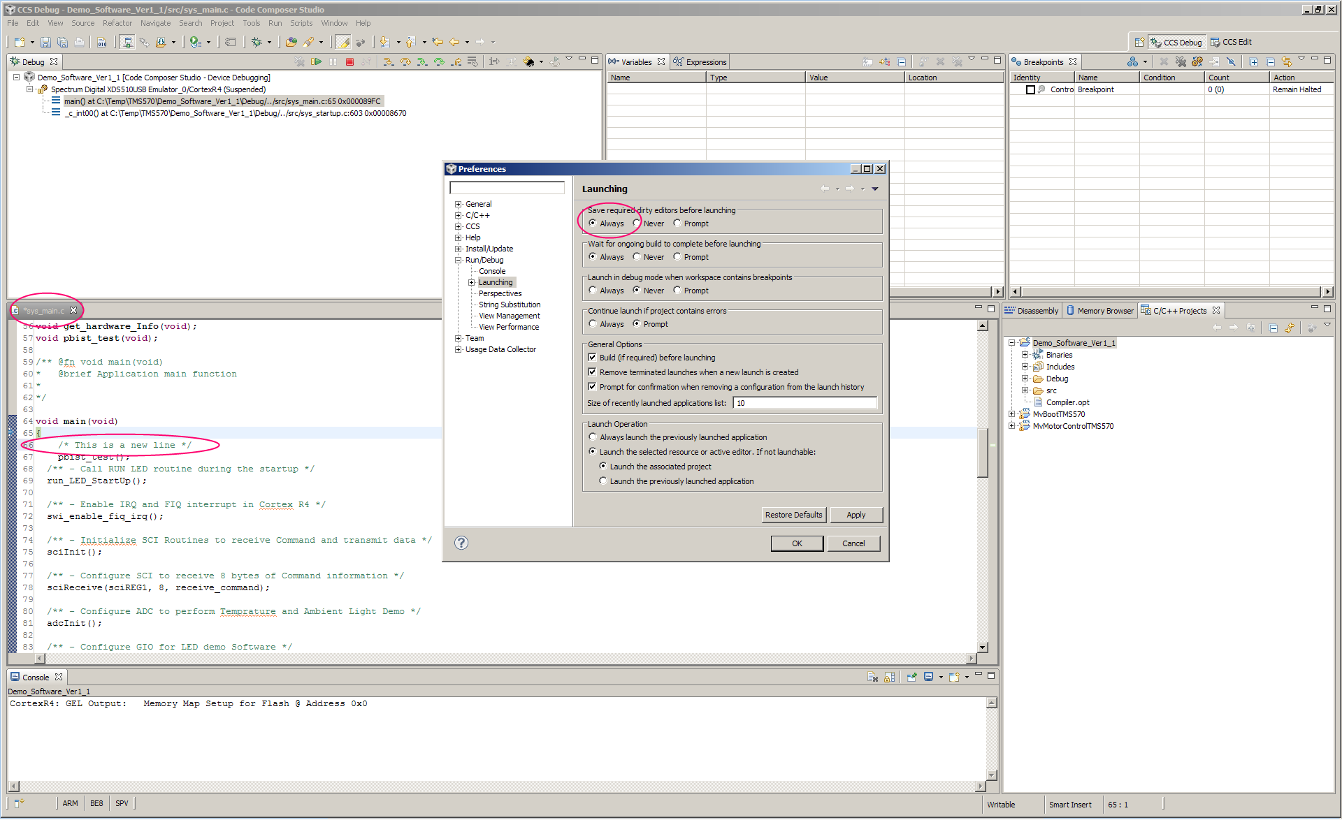

We are using CCS 5.0.1.00026 with a TMS570 and an XDS510 USB debugger.
This may be a "feature" of the latest Eclipse version but on CCS4, if the debug button was pressed, all edits were saved and a compilation took place before starting the debug session. On CCS5, edits are not automatically saved if the debug button is pressed (edited files still have a * against them in the debug perspective).

    First issue: You should be getting asked if you would like to save your files. This should happen if you are doing a debug project action(a project is selected or a source file belonging to a project is active and in focus). This prompt will not happen if you are trying to debug a project that contains no modified files. If another project contains modified files then you will also not get prompted. i.e. You will get asked only if files needed for debug session start are dirty. The other possibility is that the option that controls this behaviour has been changed (you would need to go to WIndow menu; Preferences; then expand Run/Debug and click on Launching ) At the top there are options that control what to do when dirty editors exist during Launching (i.e. starting of a debug session).

  • Hi Martin,
    Thanks for the quick response. Your second suggestion is useful although not quite as convenient as the feature in CCS4 :(
    However, the first issue still appears to be present despite setting the options in CCS5. I have attached a screenshot. Am I missing something?
    If I hit the build button rather than the debug button any changes are automatically saved.

  • Hi Richard,
    Yes, it is definitely not as nice. We are planning on resolving the auto build/reload in next month or two.
    I can't figure out what might be going wrong with the other issue. Everything looks very similar to my setup and I do get prompted to save. Could you attach couple more screen captures? Beside "bug" button used to start debug session, there is a drop down arrow, could you click on it and select "Debug Configurations...", then click on "Demo_Software_v1_1" node under "Code Composer  Studio - Device Debugging" and do two screen captures when "Main" tab is in focus and then "Program" tab .

  • Hi Richard,
    Unfortunately, things look ok here as well. Would you be able to share your project? If you don't want to post your project publicly then you could start a private conversation with me.
