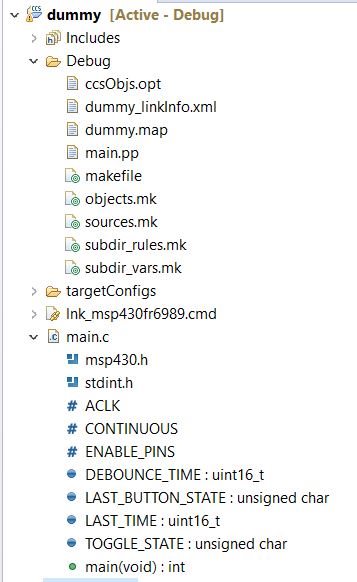

  • What happens is I build the project successfully without any errors or warnings and then when I press
    debug, the .out file and "Binaries" file gets deleted.
    Here's what I noticed tonight, I created a project called 'dummy' which included a main.c with it, built
    and ran it before adding any code and it builds successfully. When I take the main.c code from the old project
    parse it into the body of the main I get the same error as on the previous project. It doesn't seem to care whether
    I format the main.c as either forms seen below as both those forms of main have compiled for me in previous projects
    without the loading error we are talking about. It doesn't seem to be the formatting of the main().

    I'm going to try and attach the text file of the code along with the before and after pressing debug of the dummy
    project tree. The site seems to be having issues with attaching things at the moment, these weren't issues I had
    the first time I reached out.

  • Here's the build - it mentions some kind of error but doesn't flag it in the errors table
    **** Build of configuration Debug for project LCD_DisplayWord ****
    "D:\\Texas Instruments\\ccsv6\\utils\\bin\\gmake" -k all
    'Building file: ../main.c'
    'Invoking: MSP430 Compiler'
    "D:/Texas Instruments/ccsv6/tools/compiler/ti-cgt-msp430_4.4.3/bin/cl430" -vmspx --abi=eabi --data_model=restricted --use_hw_mpy=F5 --include_path="D:/Texas Instruments/ccsv6/ccs_base/msp430/include" --include_path="D:/TI Projects/LCD_DisplayWord/driverlib/MSP430FR5xx_6xx" --include_path="D:/Texas Instruments/ccsv6/tools/compiler/ti-cgt-msp430_4.4.3/include" --advice:power=all --advice:hw_config=all -g --define=__MSP430FR6989__ --diag_warning=225 --display_error_number --diag_wrap=off --silicon_errata=CPU21 --silicon_errata=CPU22 --silicon_errata=CPU40 --printf_support=minimal --preproc_with_compile --preproc_dependency="main.pp"  "../main.c"
    At end of source: error #68: expected a "}"
    "../main.c", line 33: remark #1544-D: (ULP 13.1) Detected loop counting up. Recommend loops count down as detecting zeros is easier
    "../main.c", line 33: remark #1527-D: (ULP 2.1) Detected SW delay loop using empty loop. Recommend using a timer module instead
    1 error detected in the compilation of "../main.c".
    >> Compilation failure
    gmake: *** [main.obj] Error 1
    gmake: Target `all' not remade because of errors.
    **** Build Finished ****
    This is definitely a compile error that would prevent the *.out file from getting generated.
