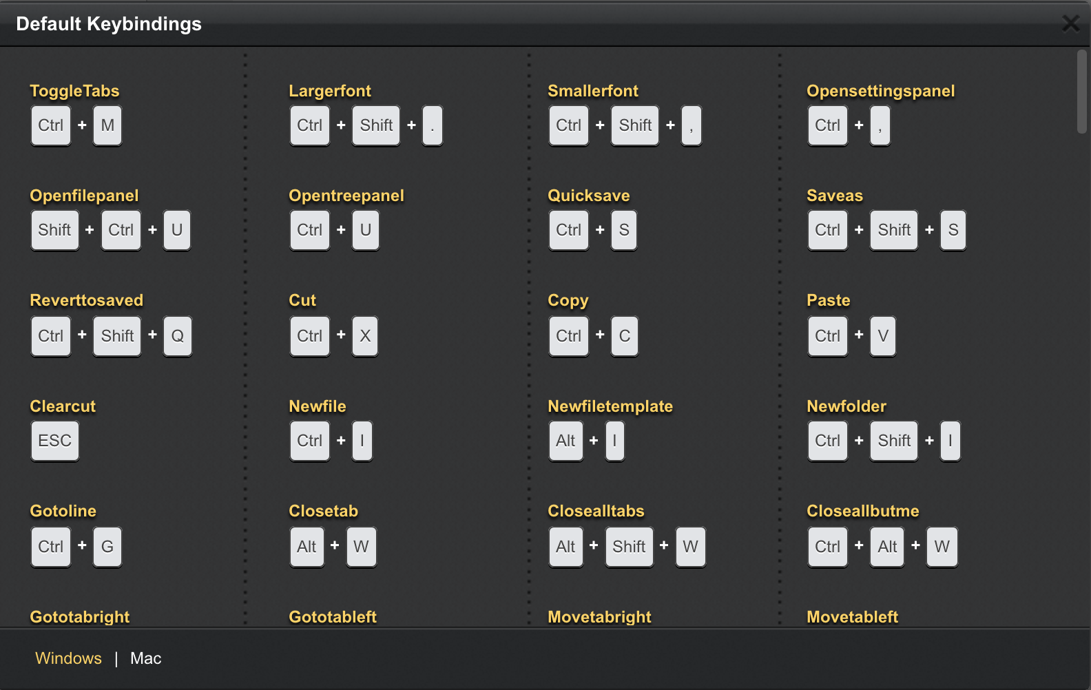

    In the desktop version of Code Composer Studio there are back/forward buttons on the toolbar that you can use for this:
    In CCS Cloud there is no equivalent that I am aware of.  If the definition is in a separate file then it would have opened a new tab in the editor and you could select the previous tab to go back.  However if it is in the same file then there is no way to automatically go back.
    I looked through the keybindings and didn't see anything that matched:
