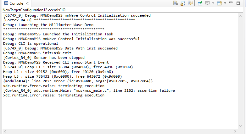

after designing a Chirp with Estimator mmwave sensoring. I debug with CCS, but may find this error. I need help

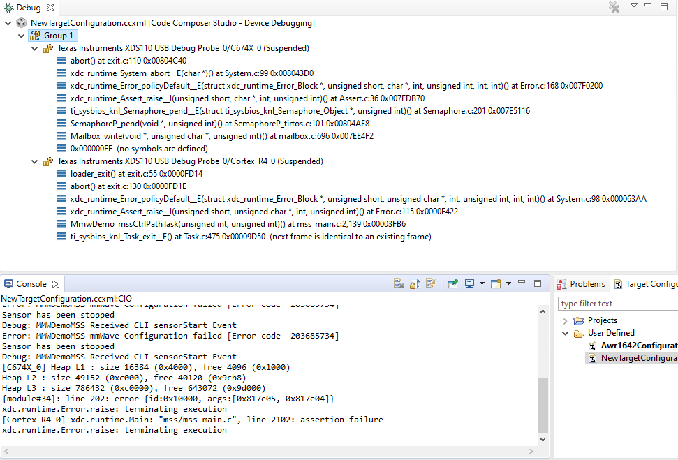

In the console there are multiple errors which is cropped in the snapshot. Could you provide the full console log with the error message.
And please provide the SDK version, which application and the change list.

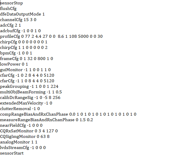

Here are some answers that have been provided in similar E2E posts:
"The BSS is an R4F ARM core that runs firmware that is not user modifiable. MSS and BSS communicate using Mailbox and EDMA. If you are causing the BSS to crash, it is likely that your EDMA modifications have disrupted MSS to BSS communication. Another possibility, is that your profile config is bad in some way and the error managed to elude the sanity checking."
"This CPU fault occurs when BSS tries to send some message (response/async-event) to MSS/DSS core and MSS/DSS doesn't clear the mailbox within required time range and in that time there are multiple messages are queued up at BSS end which further causes mailbox message queue full error and FAULT.
For this make sure if application has enabled mutliple calibration/monitoring report then application should read those async event messages as fast as possible from the mailbox."

Hi Kyle
I make adjustments and corrections in the configuration file. it worked.
thanks
