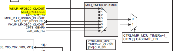

    I think I know what is happening with SBL boot flow in you case.
    The MCU domain has 9 timers DMTimer0:8 and the DMTimer0 in case of running from SBL is configured for a frequency of 250MHz as compared to the other timers being configured for 19.2MHz.
    You can see in the file bios_6_76_03_01/packages/ti/sysbios/timers/dmtimer/Timer.xs (line 1665 under the "J7.*_MCU" structure in DMTimer0) that all the timers are expected to be configured for 19.2MHz.
    So if there is a difference between what you actually configure (from the SBL or GELs) and what you expect it to be configured for (either sysbios cfg file or Timer.xs) then you will see a difference between what you configure the timer callback to be and what it actually gets configured to.
    Now when you use SBL, it configures the same DMTimer0 for a freq of 250MHz (you can look at the register 0x40F08100 i.e. the CTRLMMR_MCU_TIMER0_CLKSEL register the value there is 1)
    The reason why using CCS didn't give any abnormality with regard to the timer task getting called was because CCS GELs configure the same DMTimer0 for 19.2 MHz (mux value is 0)
