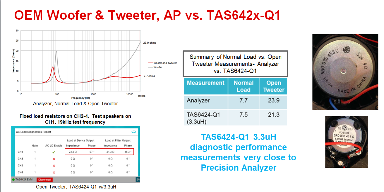

Where can I set the time delay between every speakers to create directivity effect?
Maybe is this part in following picture, or something else?
Thanks.
Hi Joan,
You need play a 19KHz, 0dB sine wave audio source to device, using external signal generator.
Before you do AC diag, I suggest you can do DC diag firstly to check if any DC load error.
Regards.
Derek
