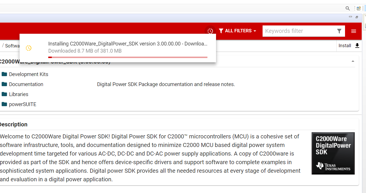

Please help me - I am stuck at downloading of C2000WARE-DIGITALPOWER-SDK.
I downloaded the CCS V10 and from that I surfed about C2000WARE-DIGITALPOWER-SDK and clicked the install button which is available to the right.
After this it is showing error about to download the sdk which is "SOCKET HANG UP ". which is depicted in the below picture.
Please help me with the issue.

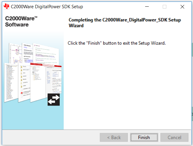

    and second -
    I dont find problem downloading the DIGITALPOWERSDK but I am stuck at installing the same software. I am at a stage where I am unable to find problem whether it is due to some lack of software download or lack of some file.
    I have already downloaded the zip file of DIGITALPOWERSDK from the ti link which says:
    https://www.ti.com/licreg/productdownload.tsp?toPerform=productDownload&location=https%3A%2F%2Fdownloads.ti.com%2Fdownloads%2FC2000%2Fc2000_apps_public_sw%2Fc2000ware_sdk%2Fdigitalpowersdk%2F3_00_00_00%2FC2000Ware_DigitalPower_SDK_3_00_00_00_setup.exe%3F__gda__%3D1587883303_87919c8ee1494593b90a3c869c78d2f9
    and the .exe file also. After doing so I tried installing it locally through this downloaded file. The installation wizard opens up and completes till finish. like u can see in this picture.
    Now when i start CCS v10 and import any project TIDM then it asks me to first install DIGITALPOWERSDK and here when I click the install button it shows me "HANG UP" error message. So please help me with the same.

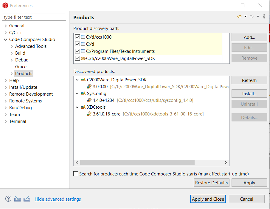

  • Ok I have passed the log onto the Resource Explorer team to see what is going on.  As far as the import error on asking you to install the DIGITALPOWERSDK lets see if we can correct that.  Basically the projects state that they need this product and CCS is not aware that you have it installed.
    If you go to Window -> Preferences in CCS.  Navigate to here:
    Add the locaiton where the SDK is installed in the top right box.  Then click refresh and see if it shows the "C2000Ware_DigitalPower_SDK" in the list at the bottom right.  If that shows up you can go back and try to import the project.
    John

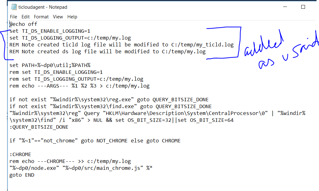

  • Thank you Jeelka.
    The team looked at the logs and think that something may be going on with something called TI Cloud Agent, which is a service that Resource Explorer uses.  It has its own set of logs.
    Could you go to: <ccs install dir>/ccs/ccs_base/cloadagent/ticloutagent.bat and add these lines to the top.
    set TI_DS_ENABLE_LOGGING=1
    set TI_DS_LOGGING_OUTPUT=c:/temp/my.log
    REM Note created ticld log file will be modified to C:/temp/my_ticld.log
    REM Note created ds log file will be modified to C:/temp/my.log
    In this example above, the log will be located at C:\temp\my_ticld.log.
    Then restart CCS and try to use Resource Explorer again to get the SDK.
    John
  • hey JohnS,
    Look i did these changes in the way you mentioned (refer the image attached)  but still no output.
  • hey JohnS,
  • Hey JohnS,
    Like you asked to add these lines in the file location mentioned , I did exactly the same thing but now i am getting an error that i could not link to the cloud agent. Refer the same in the attached images.
    Taken the file as mentioned in the path:
    And after refreshing CCS and restarting it, either i click to the install button next to DIGITALPOWERSDK or IMPORT the project from the folder, I am getting the error message that is attached in the next file below:
  • Try using the following lines in the ticloudagent.bat file instead. Note this will add the log file to C:\ti instead. If you point it to a folder which doesn't exist it won't work (which is why it's failing for you).

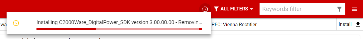

  • Hi James,
    I got the .bat file correct and now the error for the cloud agent installation is gone.
    But the original problem of unable to install the C2000Ware_DigitalPower_SDK is still coming;  .
     I am stuck at this now please help me and solve this issue. Herewith I am attaching the error

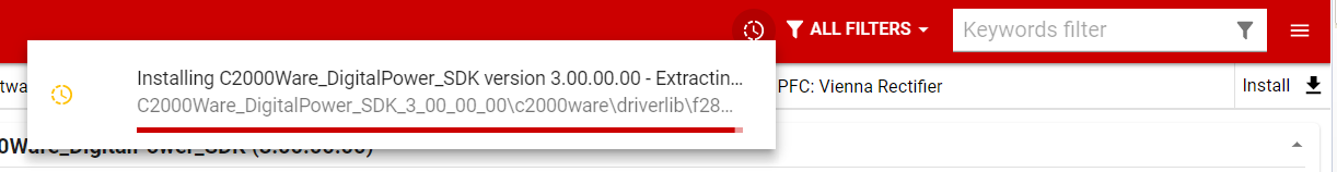

  • Hi James,
    Also, When I tried to import the project file, it showed me error like shown in the below image.
    I have downloaded the sdk from the ti website http://www.ti.com/tool/C2000WARE-DIGITALPOWER-SDK .
    This gives me a .exe file with which i have installed locally at the same path C:\ti\ and which has all the matadata files and updater.
    And still in CCS while i Want to use DIGITAL POWERSDK from CCS it asks me to install the same and when i click install it downloads, installs, extracts and then does as metioned below:
    Every time i click install, it downloads the sdk in the path i mention C:\ti\  and it starts installation, following extraction and after some times it says "removing" and then gives error.
    Also, JohnS, asked me to do the following:
    And So, in response to this I did this :
    AM I CORRECT ?
    But still I am getting error of SOCKET HANG UP.
    Please let me know what I should do?

  • Sorry to hear that,
    Unfortunately this will be a bit of trail and error. For some reason your connection gets aborted but we have no info as to why this happens.
    I added a log to see what server your machine is trying to connect to. If you add the files attached then reply back with a new log we can see what we get.
    "offline-metadata-manager" should go in C:\ti\cs\ccs10.1.0.1\ccs\tirex4\ti-rex-core\out\cloudagent (rename attached file to "offline-metadata-manager.js").
    "offline-product-tree" should go in C:\ti\ccs\ccs10.1.0.1\ccs\tirex4\ti-rex-core\out\cloudagent\offline-metadata-internal (rename attached file to "offline-product-tree.js").
    If it's possible I'd suggest trying to connect to a different network.
