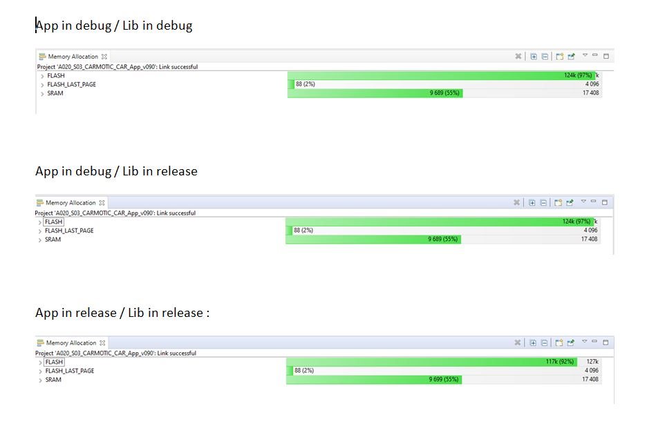

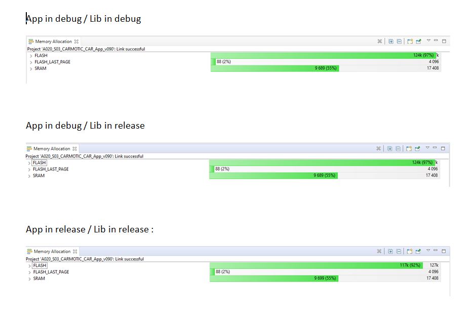

  • Hi again,
    Ok, you says that debug information generated by compiler has no effect on the size of the instructions code generated.
    But in that case there is something different between application and library :
    - Application compiled as release without debug information, allows to save more than 7kB
    - Library compiled as release doesn't change any thing...
    See image below, it looks like is debug change the generated size of the application code but not for library code ?
    Why this difference ?
    As another working direction, what would you recommend to save space in flash code area ?
    I started my application from the ProjectZero example that came with "LAucnch XL CC2640" and will need to free some space for my close future developpment.
    Thank's.
    There must be more differences in these builds than whether the debug information is emitted or not.  We need to compare all of the compiler options for these two builds.

  • Your debug builds use no optimization, while our release builds use level 4 optimization.  As expected, this difference causes a large reduction in code size.
    As an example, the first C file compiled in the log file AppDebug_LibDebug.txt and the log file AppRelease_LibRelease.txt is named flash_spi_ll.c.  The debug build use the option -Ooff while the release build uses the option -O4.  This pattern is repeated for all the other C files.
    Thanks and regards,
    -George
  • Hello !
    If I well understand, my configurations for release are good ?
    Alright, but in this case I was exepecting a code size reduction also on the library, and it seems not to be the case. I can't see any size reduct even if I compile the library as debug or release. I checked in the AppDebug_LibRelease.txt file, around line 100 and can see that the linker takes the library in its release folder where i compiled it with all optimisations. For me this is abnormal : If the library was really compiled with optimisations, it should have an effect on the whole size ?
    Am I wrong ?
    Is ther something I don't understand ?
    Patrick
