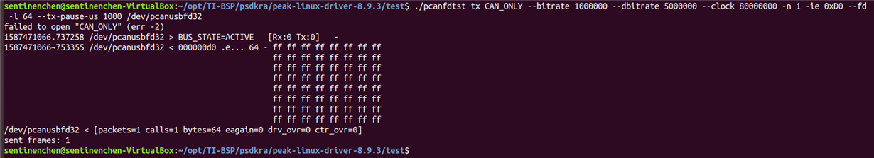

after this, I try the CAN-to-CAN test by pcanfdtst
the result seem tx already send.
but pcanfdtst rx can't receive any data
Q1: Can you help to check my test steps is correct?
Q2: When I try pcanfdtst tx, there is one error "failed to open CAN_ONLY (err -2)",  is it effect?
BR
Sentinen Chen

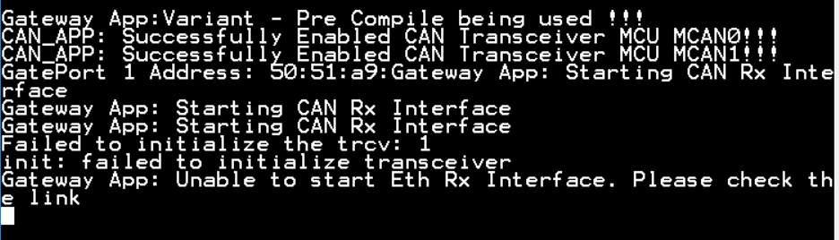

  • Hi Vineet:
    I build the 6.1 SDK's gateway-demo finished.
    And use two ways to test
    1. SPL: copy can_eth_gateway_app_mcu1_0_release.xer5f to sdcard rootfs partition's /lib/firmware/, and create link j7-mcu-r5f0-0-fw -> can_eth_gateway_app_mcu1_0_release.xer5f
    2. SBL: copy can_eth_gateway_app_mcu1_0_release.appimage to sdcard boot partition and rename to app. and copy SBL's tiboot3.bin and sysfw.bin to boot partition too.
    But I all get below log form 2nd mcu-uart instance by two ways.
    Do you have any idea about this situation?
    BR
    Sentinen Chen

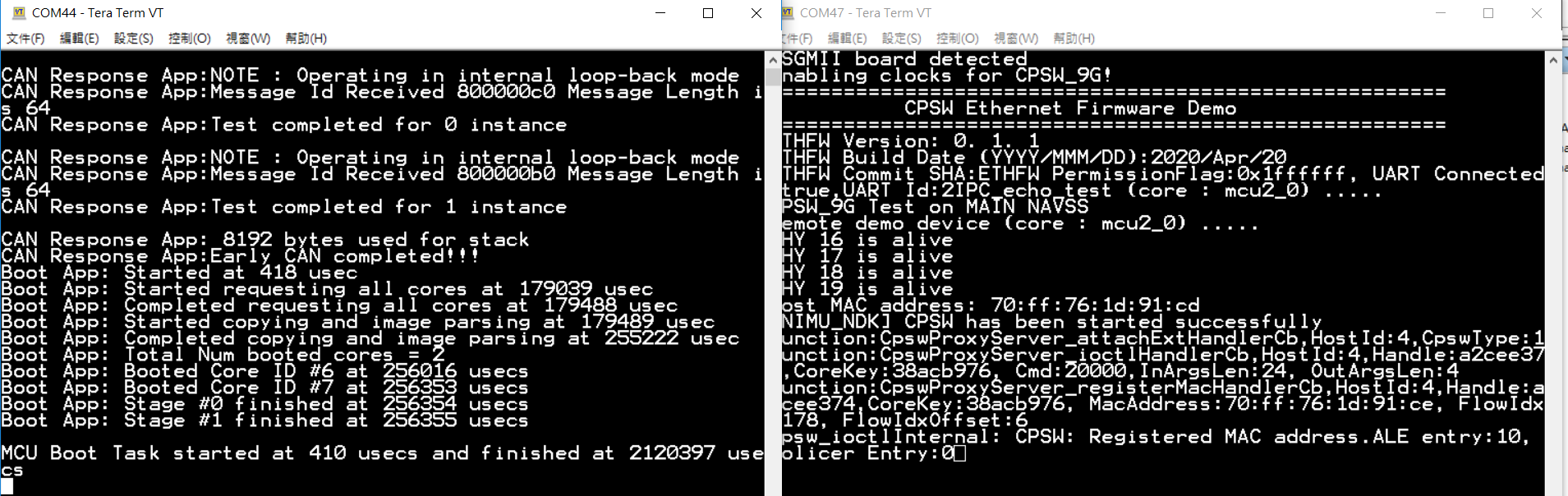

  • Hi Vineet:
    Update one new test result.
    I still test 2. SBL way,
    but this time I use tiboot3.bin & sysfw.bin which build / cp form 6.1 SDK.
    and the result is better than before,but ethfw still failed.
    Do you have any idea on this situation?
    BR
    Sentinen Chen
