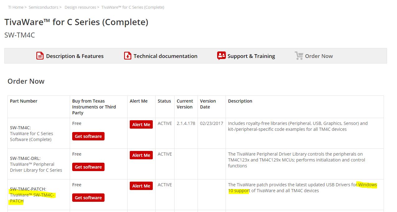

I'm working to get the TivaWare USB CDC driver to talk to Windows 10 for testing.  I'm editing the example .INF file in the documentation.  I install the .INF file and when I connect the USB cable I get the error "Device Descriptor Failure".  I have the VID and PID values correct.  Some of other messages are:
... was not migrated due to partial or ambiguous match.
Migration rank: 0xF00FFF...FFF020
I'm confused about the relationship between some of the the Descriptor Strings in the rUSBCDCDevice structure and the string definition in the [Strings] section of the .INF file.  I see the relationship between the manufacturer string in the string descriptor table (in the usb_dev_serial example) and the MFGNAME name in the .INF ("Texas Instruments"), but not for the string descriptor table entries:
Product String: "Virtual COM Port", Serial Number String "12345678", Control Interface String "ACM Control Interface" and Configuration String "Self Powered Configuration"
and the .INF [Strings] section in the example of:
DESCRIPTION_0 = "USB Serial Port" and SERVICE = "USB CDC serial port".
Thanks, Doug
  • Note that the top level error message is "Device Descriptor Request Failed.  Code 43"
  • Hello Charles
    I am not needing for my end application to work on Win10, the application will use USB to communicate with my embedded TM4C cpu and a proprietary Linux based computer, so I do not need to have a signed driver, I'm just using Win10 as a (hopefully) easy way to confirm that the USB code and interface is working on the embedded cpu.  I am able to install my .INF file without it being signed, I just need to be able to communicate with the builtin CDC usb driver.  I was hoping that someone knew what it took to have Windows allow my TivaWare USB code to communicate with it.
    Thanks, Doug
