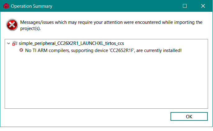

Hi Champs,
            I failed to import SimplLink latest SDK4.10 example to CCS and the error info is showed as below. Actually the ARM compile tools are installed on C:\ti\ccs1000\ccs\tools\compiler already.
            Please kindly suggest how to solve it, thanks a lot!

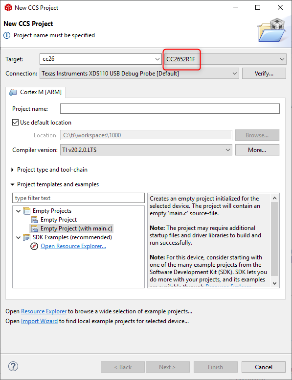

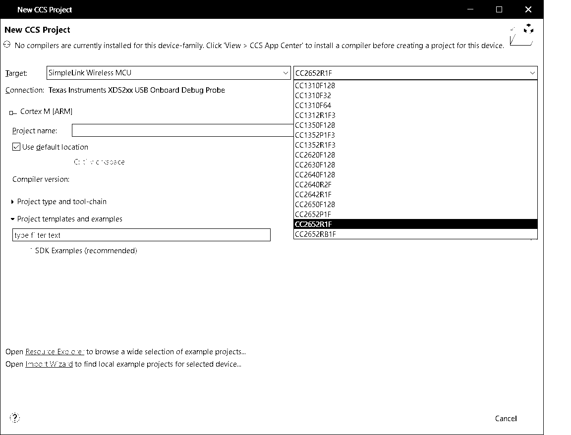

  • Ki,
              I've solved the offline resource explore issue.  I could select the CC2652 device when start a new project.

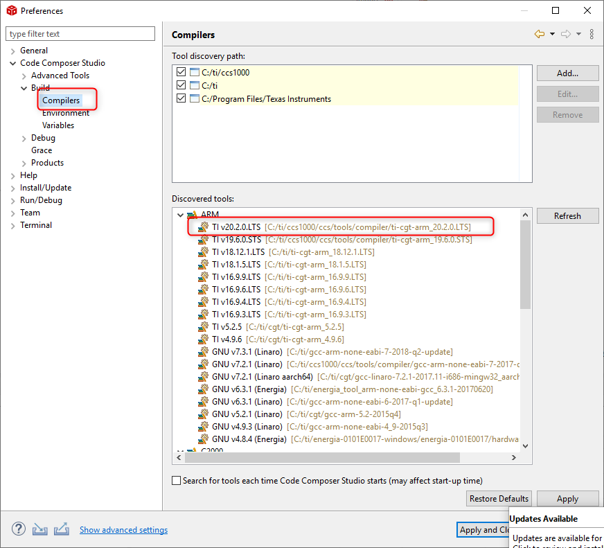

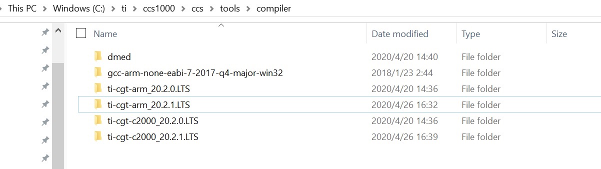

  • Can you browse to the following folder:
    <CCS 10 INSTALL DIR>\ccs\tools\compiler
    and see if the folder 'ti-cgt-arm_20.2.0.LTS' exists?
    ki
  • Ki,
            I did check and it exists
  • Can you check to see if CCS correctly "discovered" it? It should appear in the below dialog
    If it does not appear, please press the "Refresh" button.

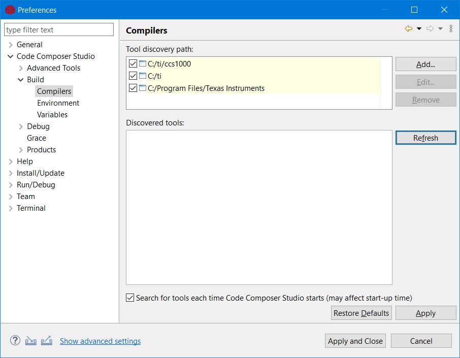

  •  Ki,
              looks like the fresh does not work, CCS could not detect the compile tools.

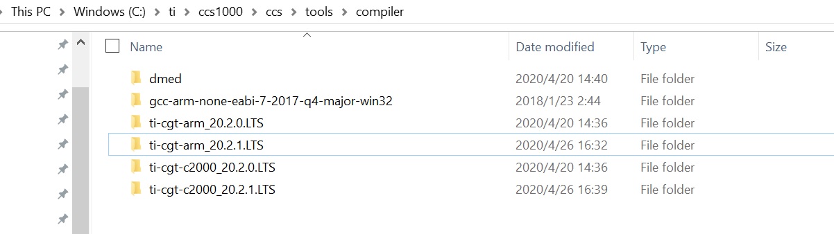

    That is very confusing. Your earlier screenshot showed that there were various compiler folders in the C:\ti\ccs1000\ccs\tools\compiler directory. Can you actually look inside those folder to see if there is any content in there? If so, can you explicitly add the direct path to one of the compilers (like C:\ti\ccs1000\ccs\tools\compiler\ti-cgt-arm_20.2.0.LTS) and refresh/restart?
  •  Ki,
              it works after I add the direct compiler tools.

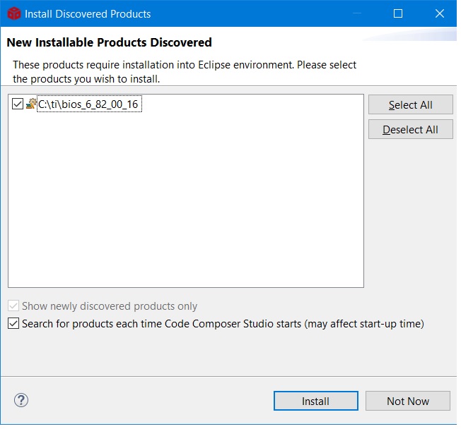

             While I encountered another issue when port the project. CCS indicates I need install BOIS while this tools also exists already.  Looks like CCS could not detect all the software installed.  Could you help check how to solve this issue?  I don't expect to manually add all the software:)

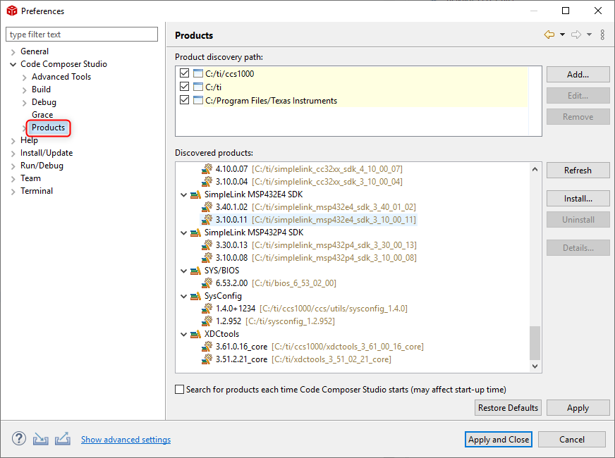

    You may have to do the same thing for bios like what you did for the compiler, except in the product discovery properties:
