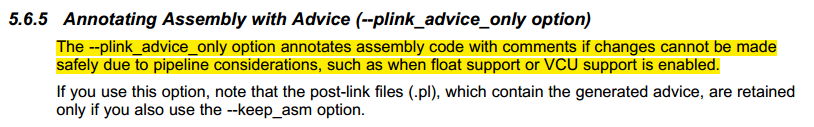

  • The c28x compiler maunal mentions information as shown below:
    As I don't use -plink option, so the removing reduant DP loads isn't active. Does this mean the blocking issue doesn't exsit?
  • The blocking issue still exists. And the best practice of defining shared variables in C28 code is still relevant.
    Blocking is done for C28 global data during code generation and is unrelated to the post-link optimization tool.
    For Data Page details see spru514t: Section 3.11 "Data Page Pointer load optimization"
    For data blocking details please see:
    https://e2e.ti.com/blogs_/archives/b/toolsinsider/archive/2016/11/17/data-blocking-in-the-c2000-mcu-compiler-explained
    Data page blocking is done so that the compiler can remove redundant DP loads, however this is done during code generation and does not require/depend-on the post-linker tool.
    The post-link tool is separate from above and one of it's optimizations involves attempting to remove even more redundant DP loads.
