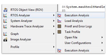

Seeking help the resolve the following issue.
RTOS Analyzer, System Analyzer and Hardware Trace Analyzer menu option are missing under the Tools option. Below is the available menu options.
I was hoping for
As indicated above I am using CCS 9.3, I reinstalled 9.1 and then upgraded to 9.3 hoping reinstalling will address the issue as discuss by some threads in this forum. My laptop is running Windows 10.
The hello_MSP_EXP432P401R_tirtos_ccs code was imported from SimpleLink MSP432P4 SDK Version 3.40.01.02 version.

Did you try the troubleshooting tips in the below link?
https://software-dl.ti.com/ccs/esd/documents/users_guide/ccs_troubleshooting.html#general-ide
If not, first try resetting the perspective (9.4.1). If that does not help, then try cleaning the workspace (9.4.3).

Thank you for your response.
I have been using the On-demand (Web) installer to install the CCSv9 and was having the above issue. I used the Single-file (Offline) installer and the issues was corrected.
Your link is helpful. I will reference your link if the issues persist.
