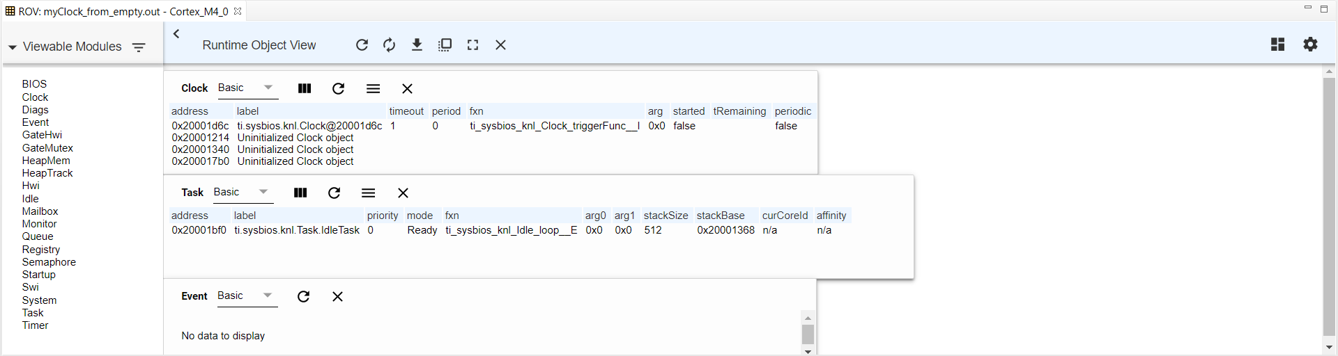

    Can you confirm the Clock function is running. You can look at it in Tools->Runtime Object View->Clock->Basic. Note: the params.period and timeout argument are in Clock ticks. So 60000000/Clock_tickPeriod = 6,000,000 Clock ticks which is 60,000,000 us so 60 seconds.
    What do the other calls to Event_pend look like? Could they be the one receiving the event? Also, what are the values of WAKE_UP_EVENT, et.al.
    Todd
  • Hi Todd,
    This is what I get:
    Otherwise, if I comment the Event_post API inside clockCallbak ROV shows me clkFxn(the callback), all the threads and also the Event pending.

    It looks like your mainClockThread function is not being called since the Clock is not in ROV. Can you confirm this?
    Is mainClockThread a task (or pThread). If so, does it do anything else? You could construct the Clock in main() instead and save a task if this is the only thing it does.
    Todd
  • Todd,
    sorry, this was my very first using ROV, maybe I did something wrong before. I tried again, refreshing also the tab in ROV, and I found my clkFxn (callback) inside the Clocks. Nevertheless, it did not post any pending threads.

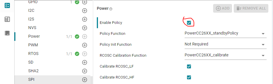

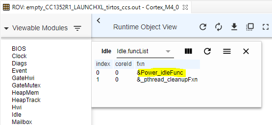

    Just another simple question: when all the threads are blocked waiting for an event_pend in which state is the CPU in?
    Thank you,
    Vincenzo
  • Vincenzo,
    If all tasks are blocked (and no Swi or Hwi is running), the Idle task will run. The Power module adds in an Idle function.
    The Idle task just loops through all the Idle functions. If the power policy is enabled (see below) the Power_idleFunc() function will go into the lowest power mode based on the current constraints. Please refer to the docs\tidrivers\Power_Management.pdf for more details.
