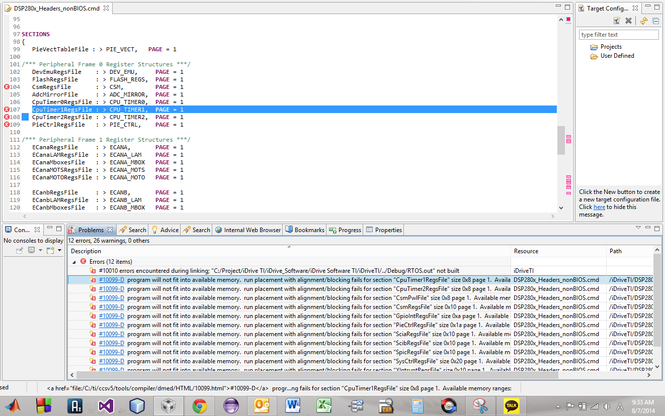

  • thank you,these errors were caused by the absence of DSP2833x_GlobalVariableDefs.c in my project.
    I upgrade code composer from v3.3 to v5 and imported the project using "import from legacy ccsv3.3. The project compiled successfully with older version but v5 gives me memory problem.
    #10099-D program will not fit into available memory. run placement with alignment/blocking fails for section "CpuTimer1RegsFile"
    Snapshot looks like this
    Can you tell me solution to this?
