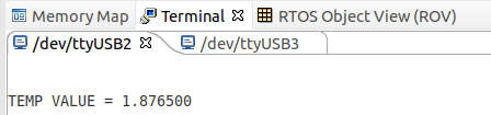

I don't have a 66AK2G12, but investigated using a 66AK2H14 using ti-processor-sdk-rtos-k2hk-evm-06.01.00.08.Krishna Boopathy J said:am currently using the "GNU v7.2.1 (Linaro)" compiler for the ARM core of the K2G.Using TI-RTOS[ti-processor-sdk-rtos-k2g-evm-06.01.00.08] on CCS 9.3.
Imported the UART_BasicExample_K2H_armExampleProject example and added the following code:
char val[40]; sprintf(val,"\nTEMP VALUE = %f",(1.8765)); UART_printf("\n%s",val);
When the code was run, sprintf() generated an empty string for the "%f" floating point format.
TI-RTOS links the Newlib-nano library, by using "--specs=nano.specs" in the linker options.Krishna Boopathy J said:I looked at project config files and UART_printf libraries. Couldn't find any option to enable floating point support.
README.nano explains that programs that require formatted floating-point input/output must explicitly reference the relevant support function during linking. For the printf() family of routines the support function is "_printf_float".
For a TI-RTOS project this can be done by adding _printf_float as an undefined symbol in the linker options for the project:
With this change sprintf then generated a float point output:
Hi Chester,
Sorry for the delay in reply.
I have tested your suggestion and it works good.
Thank you.
