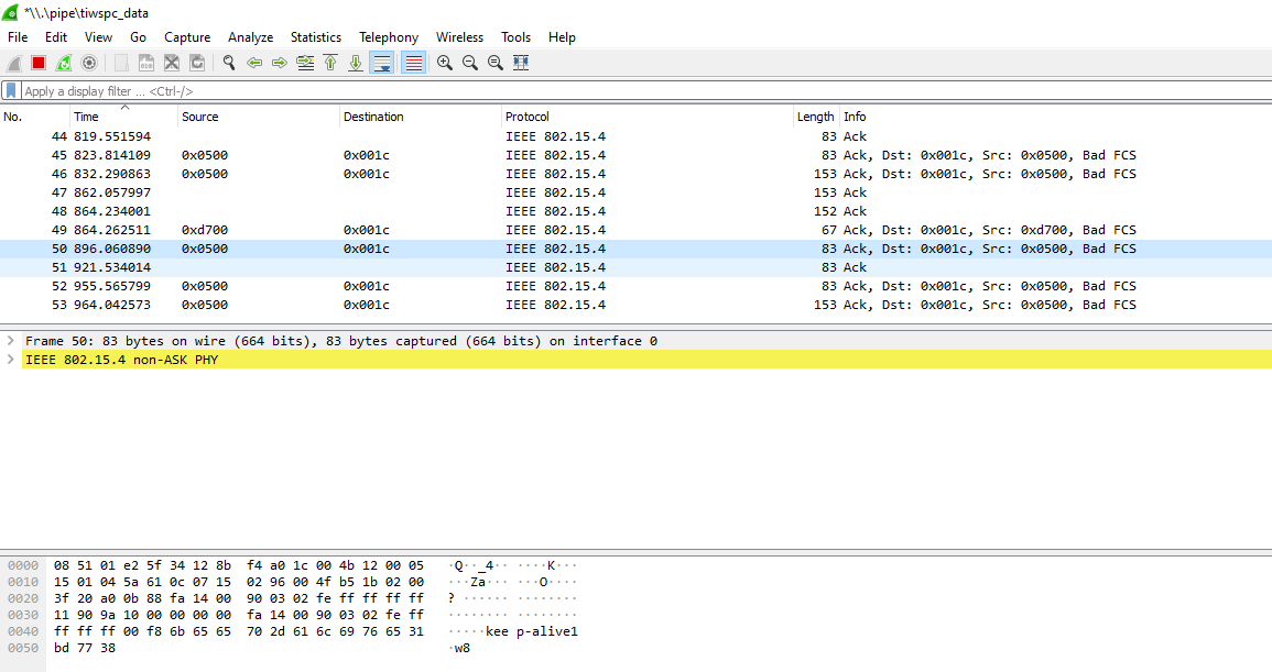

For debug purpose of Data Collector/DCU to Node architecture, I'm using a packet sniffer.
For installing I'm following this link http://software-dl.ti.com/lprf/packet_sniffer_2/docs/user_guide/html/users_guide.html
Wireshark version is 3.0.10
Packet sniffer version Smart RF sniffer agent - v 1.8.0
This sniffer is not able to decode my packets.
Its showing wrong or no value in source and destination address.
Please guide what I'm doing wrong or what other setting is required for the right result.

For better understanding, I'm attaching the picture of a packet sniffer.
My destination address is 0x26d7
my source address is 0xf48b

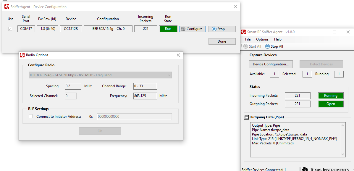

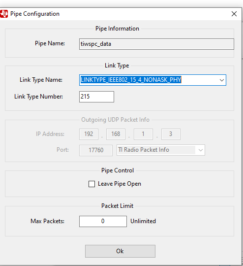

    How is the Sniffer Agent configured when you captured this? Could you please take a screenshot of the Pipe Config panel (Options->Pipe Config), and also the Device Configuration (Options->Device Config) panel?
    Bjørn
  • Thanks for reply sir,
    please find both configuration image in the attachment
    The link Type name is            LINKTYPE_IEEE802_15_4_NONASK_PHY
    The device is configured as    IEEE802.15.4g-GFSK50 kbps -  868mhz
    Can you please try set Link Type to LINKTYPE_IPV4 then test again. Are the Wireshark data then closer to what you expected?
    Bjørn

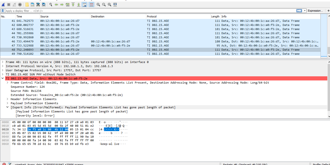

    I selected LINKTYPE_IPV4.
    In the port section, I chose the TIMAC/ TI 802.15.4ge  is this correct?
    I got the result as mention in the datasheet but some of the packets have some error. I'm attaching the screenshot can you please help me out

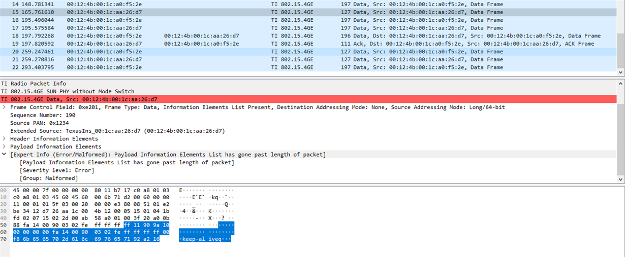

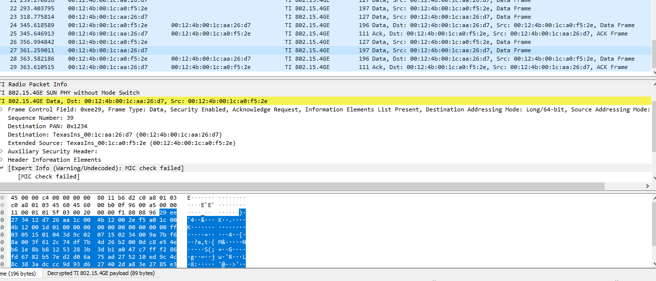

    With this LINKTYPE_IPV4 and port TI Radio Packet Info (17760) setting, I'm getting 2 different error.
    1.Expert Info (Error/Malformed): Payload Information Elements List has gone past length of packet
    2. Expert Info (Warning/Undecoded): MIC check failed
    I have attached the screenshot for the same.
    Is this packet right or some other setting is required sir?
