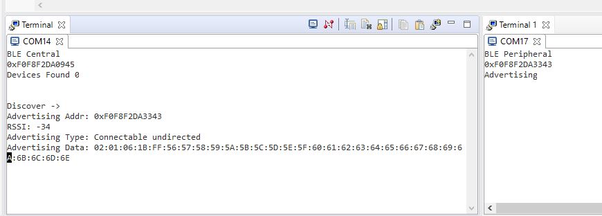

This question is with regard to the CC2640R2 Scanning and Advertising Tutorial, which worked perfectly upto Scanning Task 2 - Printing scanning results. Below is the output after implementing solutions for Scanning Task 2.
But after implementing Scanning Task 3 - Scan Indefinitely
    // === SOLUTION [Scan Indefinitely]===  (Scanning Task 3)
     #define DEFAULT_SCAN_DURATION                   0
    // === END SOLUTION [Scan Indefinitely]===  (Scanning Task 3)
the following error was observed.

  • The Error is "Invalid Parameter" shown by the following.
    Per the code this error occur due to failure the following statement
    if(pEvent->gap.hdr.status == SUCCESS)
    and due to the validity of
    if(pEvent->gap.hdr.status == GAP_LLERROR_INVALID_PARAMETERS)
                    Display_print0(dispHandle, 3, 0, "INVALID PARAMETERS");
    This occurs when DEFAULT_SCAN_DURATION is set to 0
    When DEFAULT_SCAN_DURATION is set to 4000, I don't see any error. I am unable to figure out the relation. Any help the point out the relationship is appreciated.
