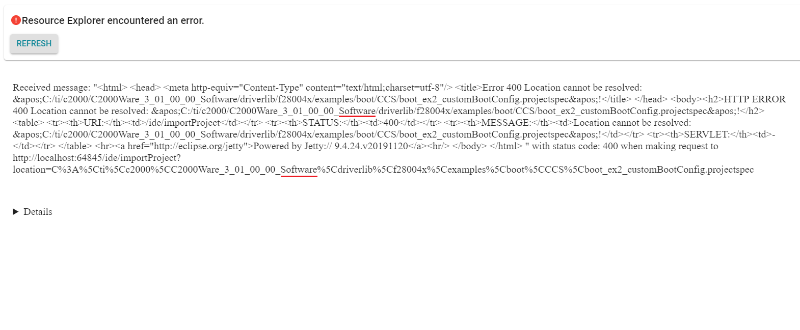

I was trying to import project from c2000ware and got path error, please fix it.
My default installation path is C:\ti\c2000\C2000Ware_3_01_00_00\driverlib\f28004x\examples\boot\CCS\boot_ex2_customBootConfig.projectspec
However in resource explorer it shows C:\ti\c2000\C2000Ware_3_01_00_00_Software\driverlib\f28004x\examples\boot\CCS\boot_ex2_customBootConfig.projectspec
    I can reproduce this also. It appears it is an issue with the Resource Explorer metadata for that example. I will notify the appropriate team to fix this.
    In the meantime, please use the CCS project import wizard to import the project (Project -> Import CCS Project). Just point the wizard to the projectspec directory.
