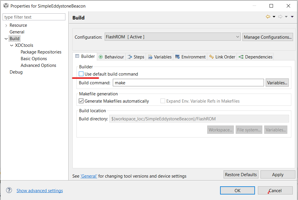

    The build seems to be calling make instead of gmake which is the typical build command for CCS projects.
    I installed CCS 6.1, BLE-Stack 2.1 and was able to import and build the SimpleEddystoneBeacon projects without this error.
    Could you check that your project has the default build command enabled like this:
    Also do you have any anti-virus, security software or Windows firewall running that might prevent access to gmake? We have seen this to cause some issues in the past. If so, you could temporarily disable the offending software or to try whitelisting CCS and its build utilities.
    Are you able to import and build other example CCS projects, from newer SDKs for instance? If yes, then the issue could be something specific to this project. If not, then it could point to a more systemic issue.
  • Sounds like that might be the issue. But I am not sure why i'm unable to click on that check box!

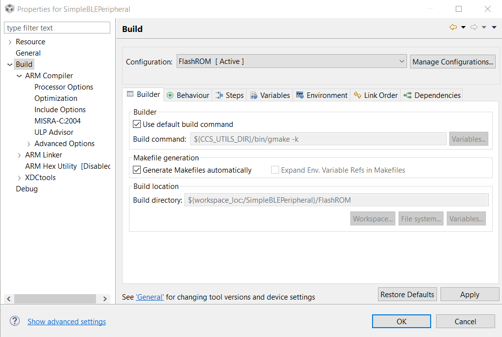

  • Yes I can import and build other examples from BLE-Stack 2.1.
    For those examples the project properties looks like this.
    But With the Simple eddystone project, the properties look likes this.
    I am unable to click on that Use default build command.
  • I wonder if some of the project files are missing or corrupted. Could you double-check that the SimpleEddystoneBeacon project directory contains the .ccsproject, .cproject and .project files? I also notice in your screenshot that the ARM Compiler and ARM Linker settings are missing under Build for this project. It might be worthwhile to download the project again from Github to be sure, and then import it into a new workspace.

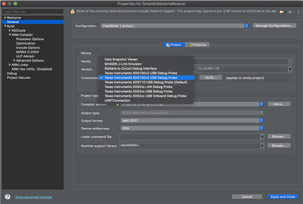

    However, I can't upload the code to the CC2640R2F Launch pad. Is this project not compatible with CC2640R2F but only with CC2640?
    Looks like this project is looking for XDS100 probe where as  CC2640R2F is XDS110.
  • True, I can't upload the code into cc2640R2F.
    Micro eddystone beacon example is non-connectable beacon right? I wanted the beacon to be configured using a smart phone App.
  • Aarti is out today.
    You can change the debug connection type that is being used in the project properties here:
    However I am not sure that you can load a program for a CC2640 onto a CC2640R2.  There is a migration guide here:
    http://software-dl.ti.com/simplelink/esd/simplelink_cc2640r2_sdk/3.20.00.21/exports/docs/blestack/ble_user_guide/html/ble-stack-3.x-guide/cc2640-to-cc2640r2.html
