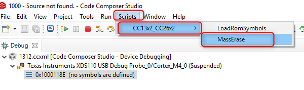

    Try the MASS ERASE option under the Scripts menu:
    ki
  • ki, thanks for your suggestion.
    "no scripts avalible" comes out form "scripts".

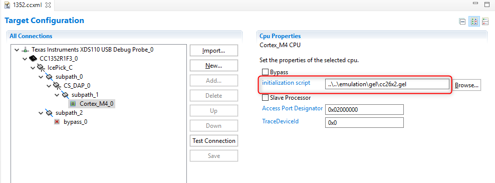

    This menu should get populated from the startup GEL file. Do you have the correct startup GEL file specified in you target configuration file?
