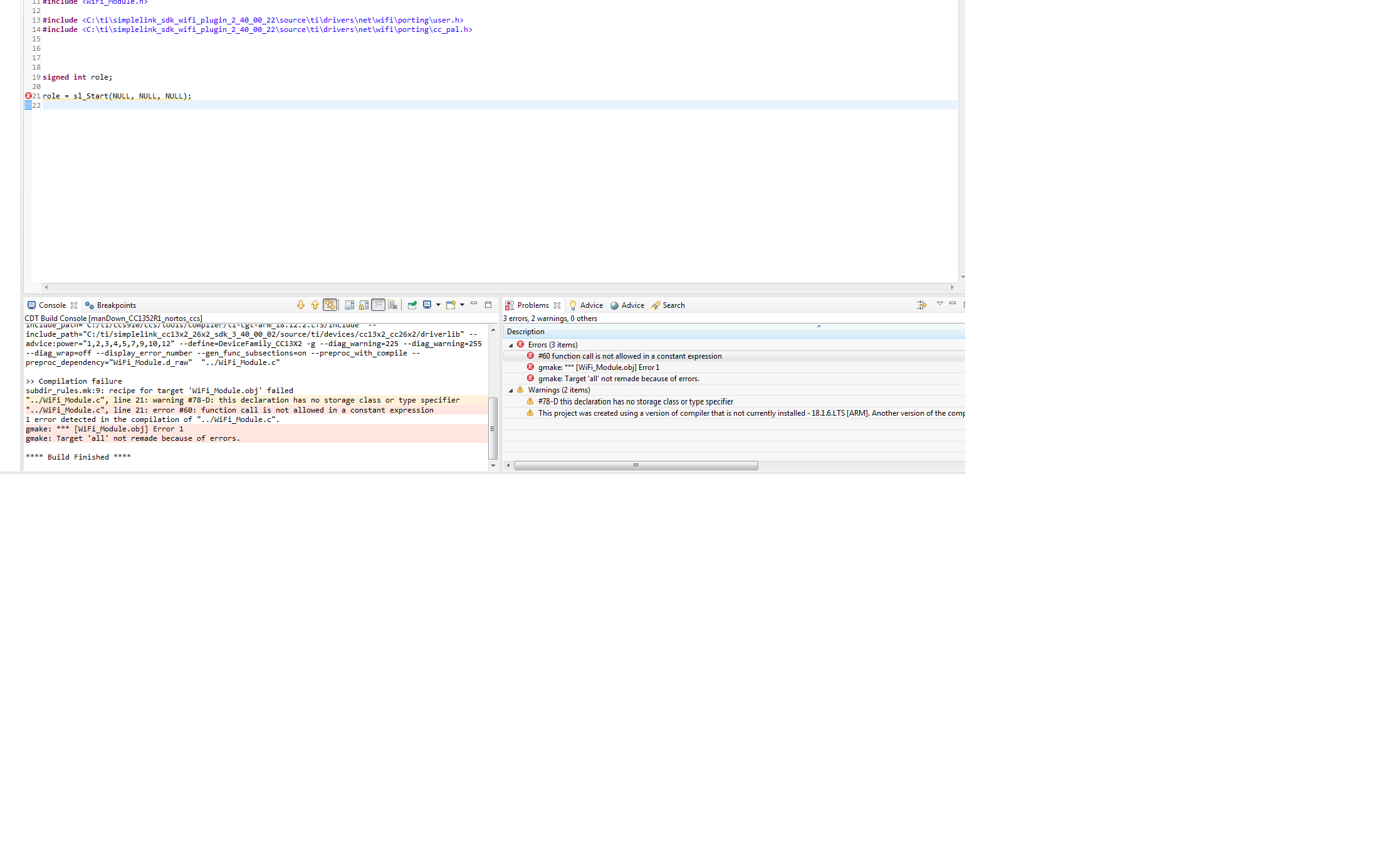

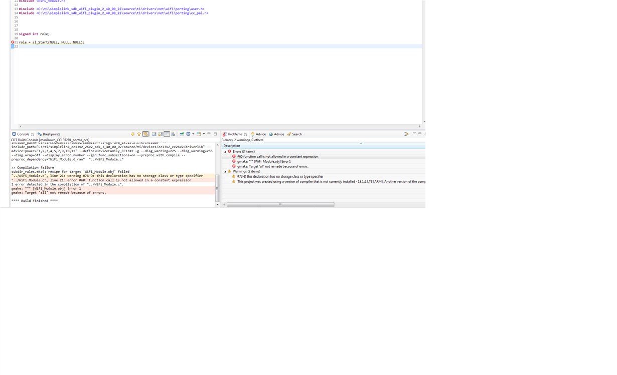

The board is custom with CC1352R.
I am trying to connect with CC3120MOD.
Invoking sl_Start I have an error and warning:
    Please start with the c26xx examples in the wifi plugin.
    Br,
    Kobi
    the example for CC26X2R1_LAUNCHXL is related to CC32xx.
    I  use CC3120MOD  connected with SPI to CC1352R.
    The problem is wit CC3120 driver porting, when using the functions from driver. Foe example the furst function which should be used sl_Start( ; ; ; ).
    The code is:
    #include <ti/drivers/net/wifi/porting/user.h>
    #include <ti/drivers/net/wifi/source/objInclusion.h>
    #include <ti/drivers/net/wifi/simplelink.h>
    #include <ti/drivers/net/wifi/device.h>
    _i16 Role;
    Role = sl_Start(NULL, NULL, NULL);
    Error:
    Description Resource Path Location Type
    #148 declaration is incompatible with "signed short Role" (declared at line 43) WiFi_Module.c /manDown_CC1352R1_nortos_ccs line 45 C/C++ Problem
