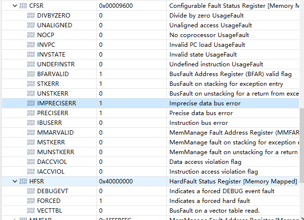

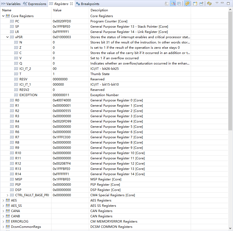

Compiler: The stack pointer(SP) points to an invalid address
      An exception occurs during the CPU run and goes into the faultISR function,and the stack pointer points to an invalid stack address.

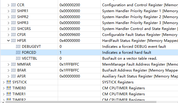

In the CMD file we set the stack address range: 0x1FFFC000 to 0x1FFFC1FF. However, the current stack pointer points to 0x1FFFBFE0(Invalid address)
Environmental information:
CPU:28388D(core CM);Compiler:CCS9.1

Figure1:Core register information
Figure2-3:CM core status register information
