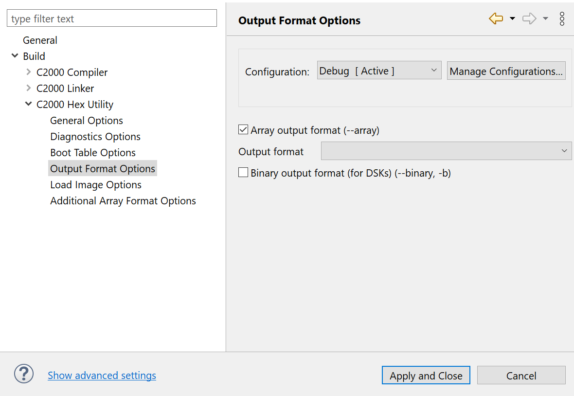

Customer wants to generate the HEX file with building the project, so the Hex Conversion Utility was enabled with CCS10. However, everytime selecting the "Array output format" in the Output Format Option, it will fail with the below information, no matter what format is selected. Could you please help check it? Thank you.
Invoking: C2000 Hex Utility
"C:/ti/ccs1000/ccs/tools/compiler/ti-cgt-c2000_20.2.0.LTS/bin/hex2000" --array --intel -o "2ph_il_llc_nonpowerSUITE_F28002x.hex" "2ph_il_llc_nonpowerSUITE_F28002x.out"
makefile:172: recipe for target '2ph_il_llc_nonpowerSUITE_F28002x.hex' failed
error: Option --array is not valid with --intel(-i)
gmake[1]: *** [2ph_il_llc_nonpowerSUITE_F28002x.hex] Error 1
