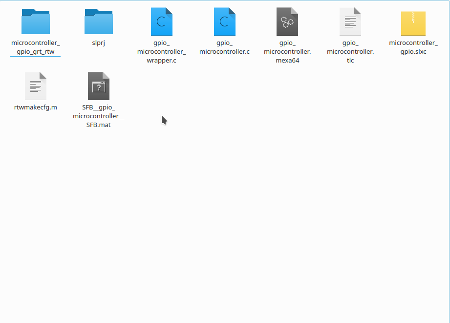

  • Could you tell me wich of these files Do I need to include into CCS?
    I include microcontroller_gpio. and microcontroller_gpio.h in CCS and Im getting this error:
    Description	Resource	Path	Location	Type
    cannot open source file "rt_logging.h"	microcontroller_gpio.h	/Matlab_simulink_project	line 31	C/C++ Problem
    Which files are included in CCS?
    Gastón
  • You will have to add the location of rt_logging.h to the compiler search path in CCS.  Select "Include Options" in the Project options tree.  It is just up from where you added RT and USE_RTMODEL.
    I can't tell you want files the MathWorks wants you to add to the CCS project.  They must have some documentaiton somewhere on that.
    John
  • Hi john,
                I can't find any doc about this (import code from simulink to ccs). I alrady contacted Mathworks about this issue. Just asking if any has already do this and maybe throw some ligth into this issue.
    Gastón
