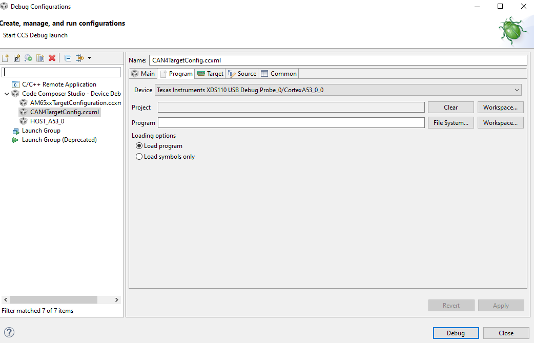

    Thanks for your response. However exporting and importing (even not as workspaces) does not allow the debug configuration to be portable. Let me show you my exact steps once again, and I will first give some more context. Currently, within our workspace we have 2 projects, one for the A53_0_0 core and one for the R5_0 core. A target configuration file is created and stored within the project directory of the A53_0_0 core project.
    1. Now, when you go to Run->Debug configurations, firstly the targetconfiguration file is not there. So first go to View->Target Configurations and launch the target configuration that is present in the A53_0_0 project directory.
    2. Terminate the debug session. Go to Run->Debug Configurations. Now the target config file can be seen. The following are then included to execute the sciclient initilization script, and automatically upload the software onto the target cores (only A53_0_0 and R5_0).
    Then clicking debug, everything uploads onto the target as expected.
    3. Now export projects into an archive file (not the whole workspace).
    4. Share to another system. On the other system, Project->Import CCS Projects and import both projects into the workspace of the other system.
    5. Now Run->Debug Configurations, then the target configuration file in the A53_0 project can not be seen (Why not???). So again, go to View->Target Configs and launch the target config file from there (right click and launch).
    6. Now, the software does not automatically upload onto the target. The sciclient initialization script also does not execute? Why? Now the target configuration file can be seen at Run->Debug configurations, but without the initialization script, and program load settings that was included on the initial system?? Dynamic variables were used for the program section, so that should also work for the other system. Below is an example screenshot of the Program load settings that are now missing on the other system:
    Thus it is clear, that all these settings should now be included again on the new system, as well as every single time a new changes is shared. Could you please advise as to what we are doing wrong?

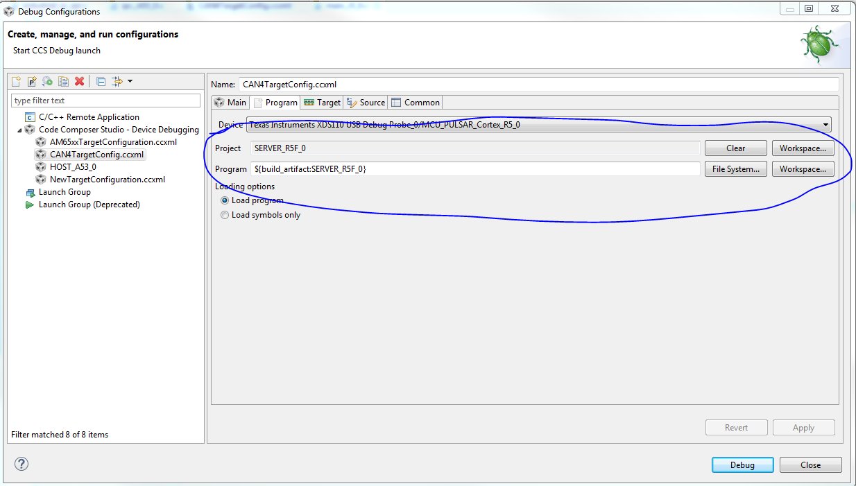

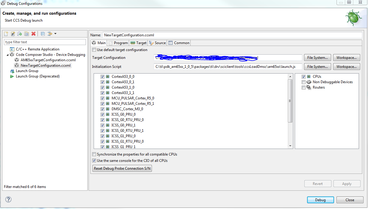

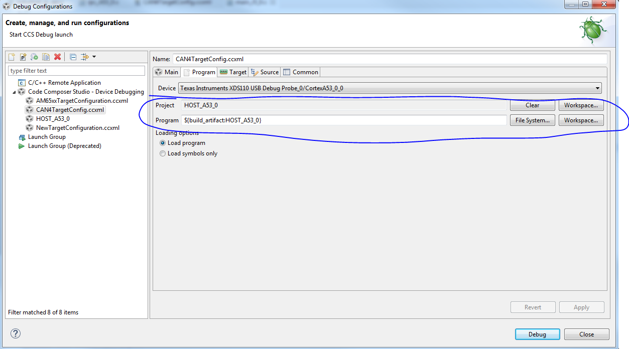

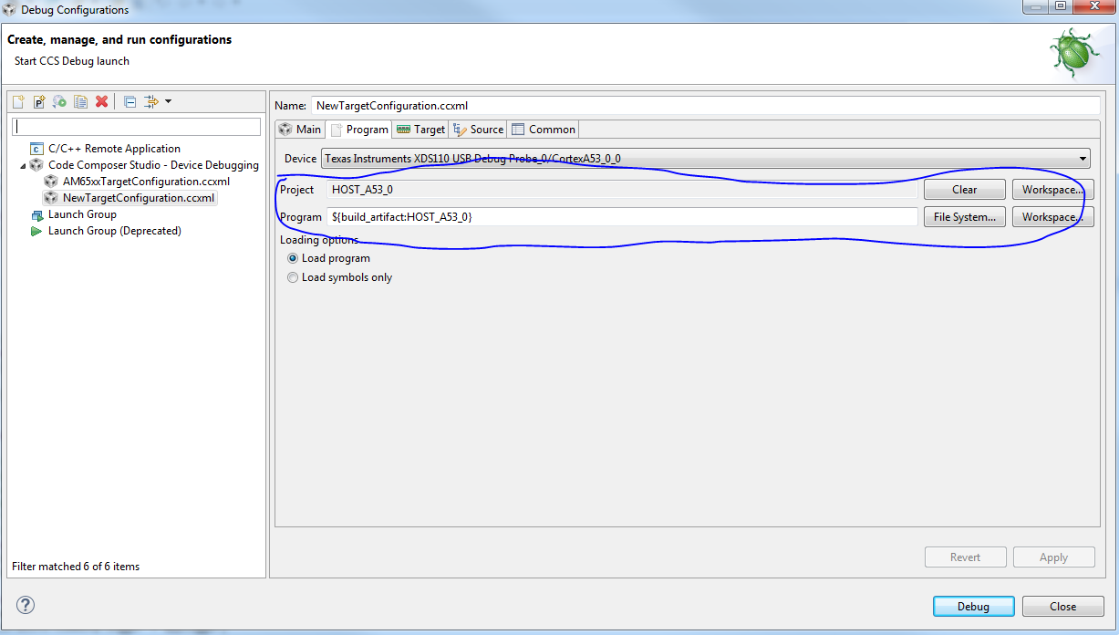

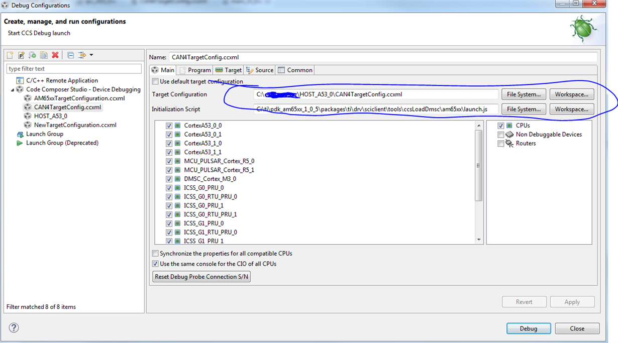

  • The location where the debug launch configuration is stored is dependent on the way the debug session is launched, as mentioned in this page:
    http://software-dl.ti.com/ccs/esd/documents/users_guide/ccs_debug-main.html#debug-configurations
    If you are performing a manual launch, the file will be stored in the workspace directory instead of the project directory and thereby not get exported to archive along with the project. If that is the case, you can export the Launch configuration separately using menu File->Export->Run/Debug->Launch Configurations. Then import it into the new machine/workpace using menu File->Import->Run/Debug->Launch Configurations.
    I tested this both ways. One where Launch Configuration is stored in the workspace, by exporting/importing Launch Configuration separately . And another where the launch configuration is stored in the project itself in which case the basic export/import was sufficient. In both cases, it worked as expected and the launch configuration appeared as expected in the new workspace.
    Please let me know if this helps explain and resolve your issue.
  • Very strange then that when we do a normal import/export, it does not work then. Yes, the target configuration file is there, but the debug configurations are missing.
    I will try to do the export seperately and see if that works for us.
    The target configuration file (.ccxml) and debug configuration file (.launch) are different and are stored in different places (as described in the User's Guide link I referenced above). The location where debug configuration (.launch) file is stored plays in part in whether it is part of the normal export or not. I hope the separate export helps resolve the issue for you.
