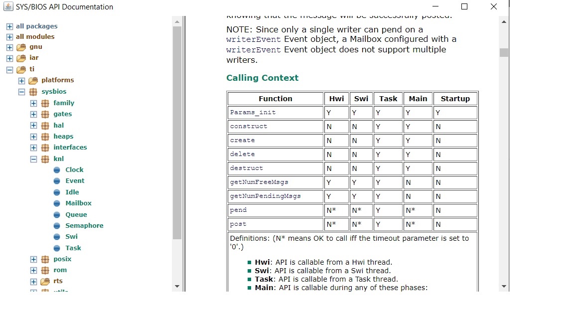

Have started working with TI RTOS. In my project I am trying to invoke an IPC from temperatureNotify driver's callback function (to send some message to my thread).
My project is derived from TI's example project: "simplelink_cc13x2_26x2_sdk_4_10_00_78\examples\rtos\CC26X2R1_LAUNCHXL\drivers\temperatureNotify"  .
TI example File name  TemperatureNotify.c
TI function name  :  void deltaNotificationFxn
I am looking at some consolidated information/doc about mapping between IPC's applicablity in HWI, SWI, device driver's callback function. Basically if we take an IPC (mail box) can I use them in HWI / SWI / Driver callback function? Any material to answer this question is good enough for me. Please share with me some help that leads to understanding the above.
