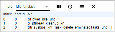

Hi ToddMullanix,
Yes, I can see _pthread_cleanupFxn running when I tested my code.
And at the same time, I checked the heap when pthread finished its task.
Check again.
Heap continue occupying by pthread. How to fix this issue? Any wrong with my sample code? Thanks.
Hi Eric,
Can you put a breakpoint in _pthread_cleanupFxn and confirm it is being hit? If Idle never runs, the memory will not be cleaned up.
Another thing you can try is to use HeapTrack to see who (and when) is allocating memory. Take a look at https://training.ti.com/debugging-common-application-issues-ti-rtos. It covers how to use HeapTrack in the last section. There is a pdf on the page in case you don't want to watch the video.
Note: for the SimpleLink SDK, the debug kernel project enables HeapTrack. Take a look at the SimpleLink SDK's User Guide to see how to use the debug kernel project (instead of the default release kernel project).
Todd
Eric,
Take a look at ROV->Task Detailed. Is there a task that never gives up the processor and thus never allows Idle to run?
Todd
Hi ToddMullanix,
Thanks. I figure out the problem. Because we use UART_readPolling which it keep thread running on the background.
Now, we use UART_read/write instead of Polling, anything looks good. Thanks.
