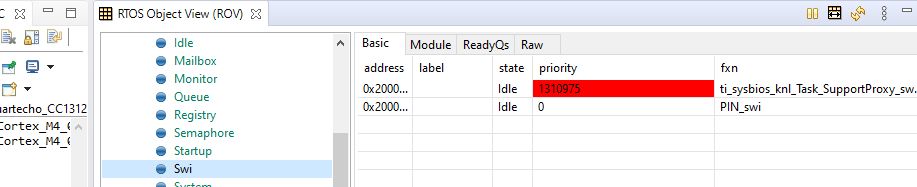

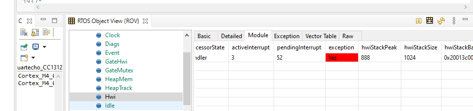

i am running an modified uart program(with adding uasrt callback  and timer callback.the program Error_policyMin after some time. and i got the following error.
can someone give me idea why will it happen

  • Hi Jeff,
    You would need to be a bit more specific, code would help. As you seem to have made quite some changes to the code, I would guess you might have overlooked an array size or you are getting a bad pointer (assuming you got some data handling going with the GSM part).
    I draw these conclusions on the fact that you seem to have a memory corruption due to the priority report of the task in ROV.

    I would try to comment out the "pinrt_debug_uart" and see if that "fixes" it. sprintf for example could require quite some stack and if your main task stack is to small, you might end up experiencing a stack overflow. Could you check the stacks of your task as well?
