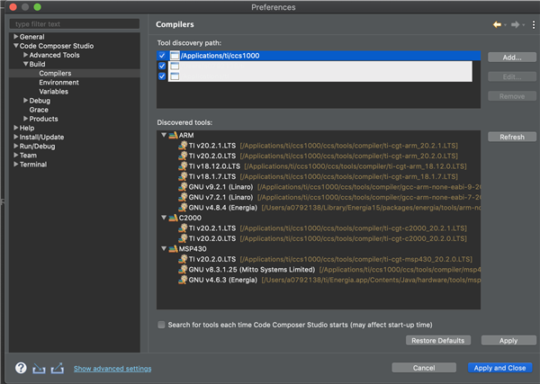

But the error message is still popping-up. The Error message poping-up during the project creation is "No compilers are currently installed for this device family ...."
Kindly suggest.
  • Sanjay,
    If you download and install the compiler from CCS then it can detect it and use it automatically.  If you manually download and install it you then need to tell CCS where you installed it.
    In CCS go to the preferences dialog.  Available from the Window menu.
    Go to here:
    Specify the path where you installed the compiler in the top section of the dialog.
    Then click refresh and the compiler shoudl show up in the bottom section.  Once it does you can use it.
