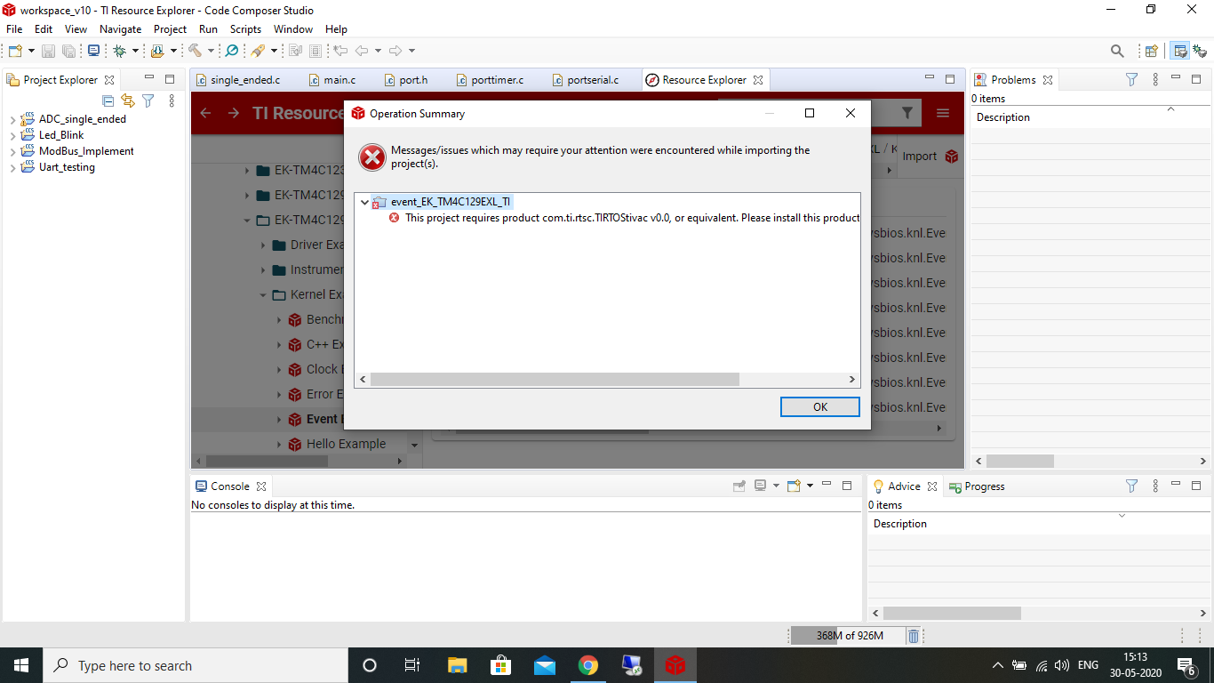

When I want to import a Ti-RTOS project , then show this error. Please tell me the solutions.

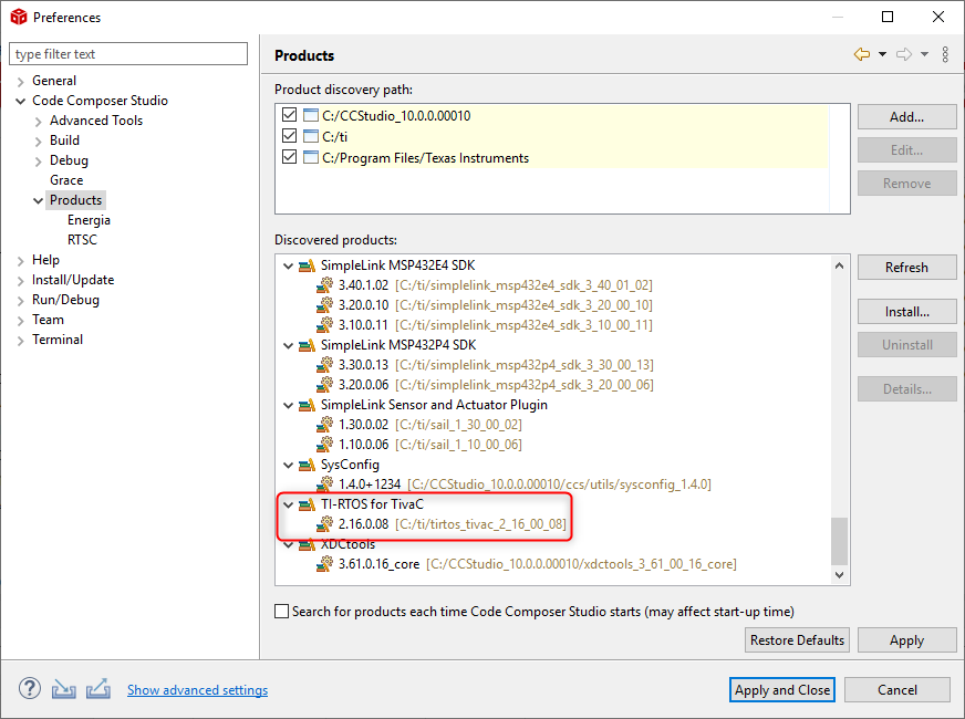

Is TI-RTOS for TivaC product already installed in your machine? If so, could you check if it is discovered by CCS as shown below?
If it does not appear there, click on Refresh, enable the TI-RTOS for TivaC product and go through the restart CCS process. After the product is discovered reimport the project.
