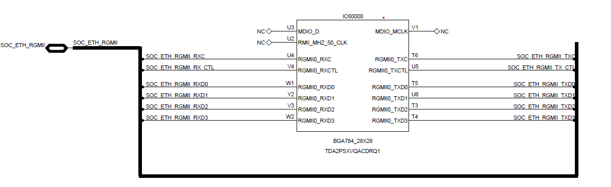

Dear supporter ,
I got a customer board with TDA2Px and a switch(sja1105P) for a new project ,  I have tried to send ARP package to TDA and read the register named 'GOOD_RX_FRAMES' , The counter increased every time but I can not get any response from TDA.
I have tried to set 'CPSW_CONTROL' as 'FIFO_LOOPBACK' and I can receive echo from TDA.
Is there anybody can give me some advices to  analyse this issue ? I do really don't know how to carry on currently.
VisionSDK 3.7.0;
bios.
Thanks for your support.
Lan.

  • Lan,
    Please confirm more details on your CPSW configuration. You should be configuring the CSPW in dual-MAC mode and not as a switch.
    Can you confirm the external switch is configured as you expect, and is this done separately from MDIO?
    Check
    vision_sdk\links_fw\src\rtos\utils_common\ndk\ndk_nsp_hooks.c
    GMACSW_Config *GMACSW_getConfig(void)
    pGMACSWConfig->macInitCfg[i].mdioModeFlags = MDIO_MODEFLG_NOPHY;
    pGMACSWConfig->macInitCfg[i].macConnectionType = MAC_CONNECTION_TYPE_RGMII_FORCE_100_FULL;

    Hi Dave,
           Thanks for your reply.
    1.I have defined the macro ‘DUAL_MAC_MODE’ in file ‘ndk2nsp.h’ and rebuild whole project ‘clean -> build’ , but after boot into application , the register info shown ‘P0_TX_IN_CTL’ not in dual MAC mode , I think there must be something I have missed .(I attached the uart debug info at end and attachment)
    2.I checked the switch configuration in Davinci , it’s looks correct. Our hardware schematic shown as below
    Only RGMII[0] connected to switch.
