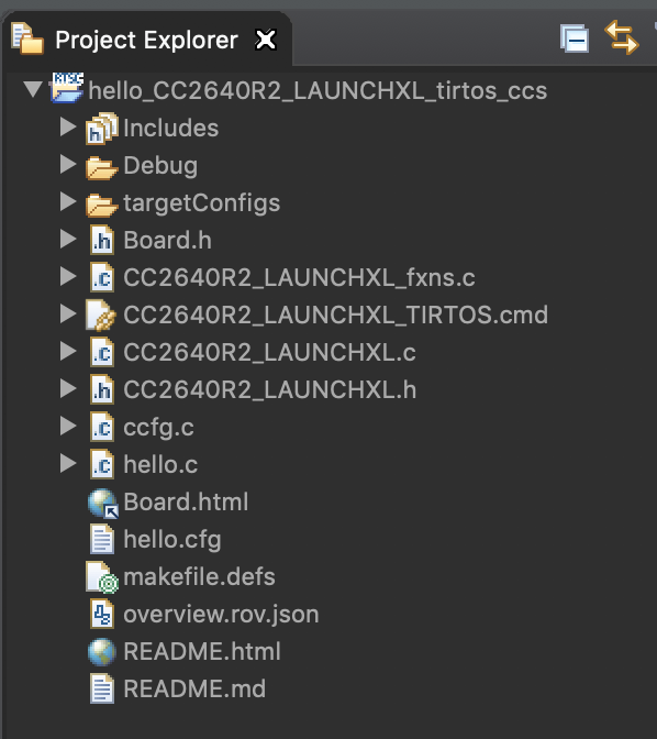

I got the hello world TI-RTOS example to run (from the simplelink CC2640R2 SDK - 4.10.00.10). Build and debug work out of the box. :-)
Next in the TI-RTOS tutorial it is suggested that I change the content of the main file (hello.c) and also edit the syscfg-file.
=> There is no syscfg-file in that project. Only a hello.cfg is there which seems to be editable by normal text editor in ccs.

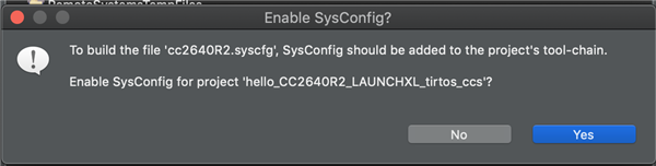

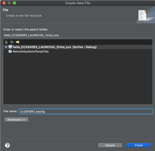

So I created an empty syscfg file and ccs asked me whether this shozuld be used in the current project, which I answered with yes.
I set the target device and package and enabled the TI-RTOS and power modules.
When I try to build that it tells me that some things got redefined - which I can understand, since now 2 config files are in the project:

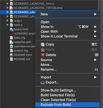

    This file is conflicting with the Board.c file that is generated by SysConfig.  You can try right clicking on the CC2640R2_LAUNCHXL.c file and exclude it from the build.  That would remove the conflict that you are seeing.   I was able to do this with the adcbufcontinuous example and get it to build.

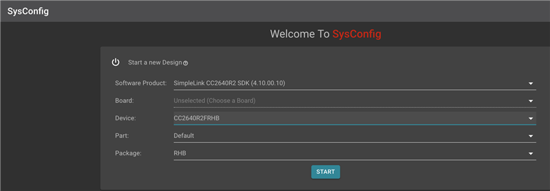

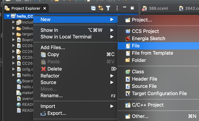

    • Next I add a .syscfg file by selecting to create a new file
    • That gives me an error about needing to specify the device
    The LaunchPad is not available in the board selection so I select the device.  Note that the SDK has to be selected in the first drop down
    I click start.
    • In SysConfig I start by just adding RTOS for now as I am not yet sure what else this example uses peripheral wise.  After adding I save.
    • Now I exclude the old CC2640R2_LAUNCHXL.c file

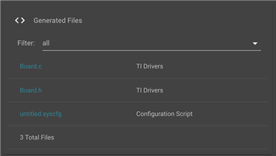

    So I get the same error about not finding the Board.c file.  Before when I was doing this I did not get this error.  I think the issue here is that the file is not being generated.

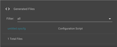

    • I open SysConfg to confirm this by clicking on the button to see what the generated files are
    This is the button on the right
    It then shows this which has no C or H files listed

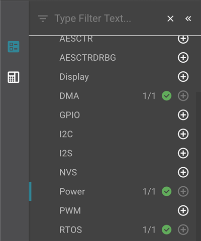

    • Next click the actions to add DMA and Power
    If I check the generated files now I can see the files will be generated
    • I save and build again
    It builds ok now
