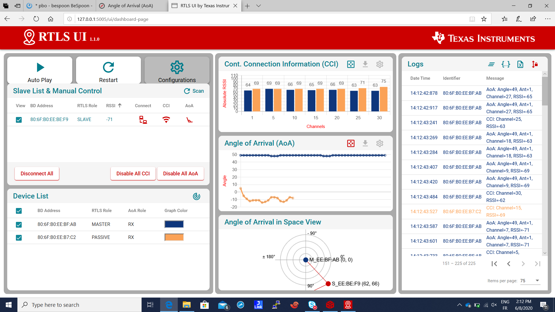

I am running RTLS AOA.
In start UI show results but after a few seconds AOA for passive device stucks and shows no more results.
please guide me how can I fix this issue.
screen shot is attached.
Orange colour show the AoA results
    This behavior is most likely due to the connection lost by the passive. The passive device does not really participate to the connection (the passive device only listen the master and the slave - the passive cannot ask the master/slave to re-send the date). As a result, the passive device can easily lost the connection, especially in a noisy environment.

    All three board are almost 2 meters apart from each other and in line of sight(LOS).
    so there should not be lost to connection issue. please help me to sort out the issue.

    I still think you are missing some packets due to the normal packet loss. Try to run conductive tests and/or to implement the "reconnection" feature I described in my previous answer.
