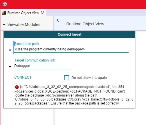

    On the other hand,  I can only get the "classic" ROV to work anyway.  For the "other" (the one that is a grid icon) ROV, I get this:
    I did a search, and there is NO file named "xdc.rov.monserver" anywhere in the XDC_3_32...  directories.  So apparently TI won't give you one.
    I downloaded and installed packages per the tutorials that are on-line.  So I have no idea where it would be.
    Where do I get this file?  Did TI even make one for this version of XDC?

  • The newer Runtime Object View requires XDCtools 3.50 or higher. Please note, that moving to a newer XDCtools will require that you use a newer SYS/BIOS.
    Todd
