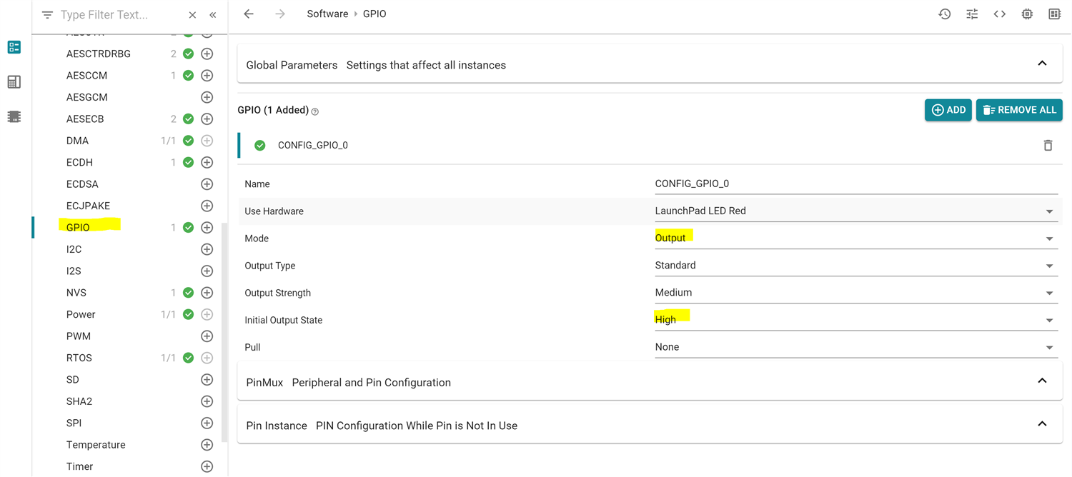

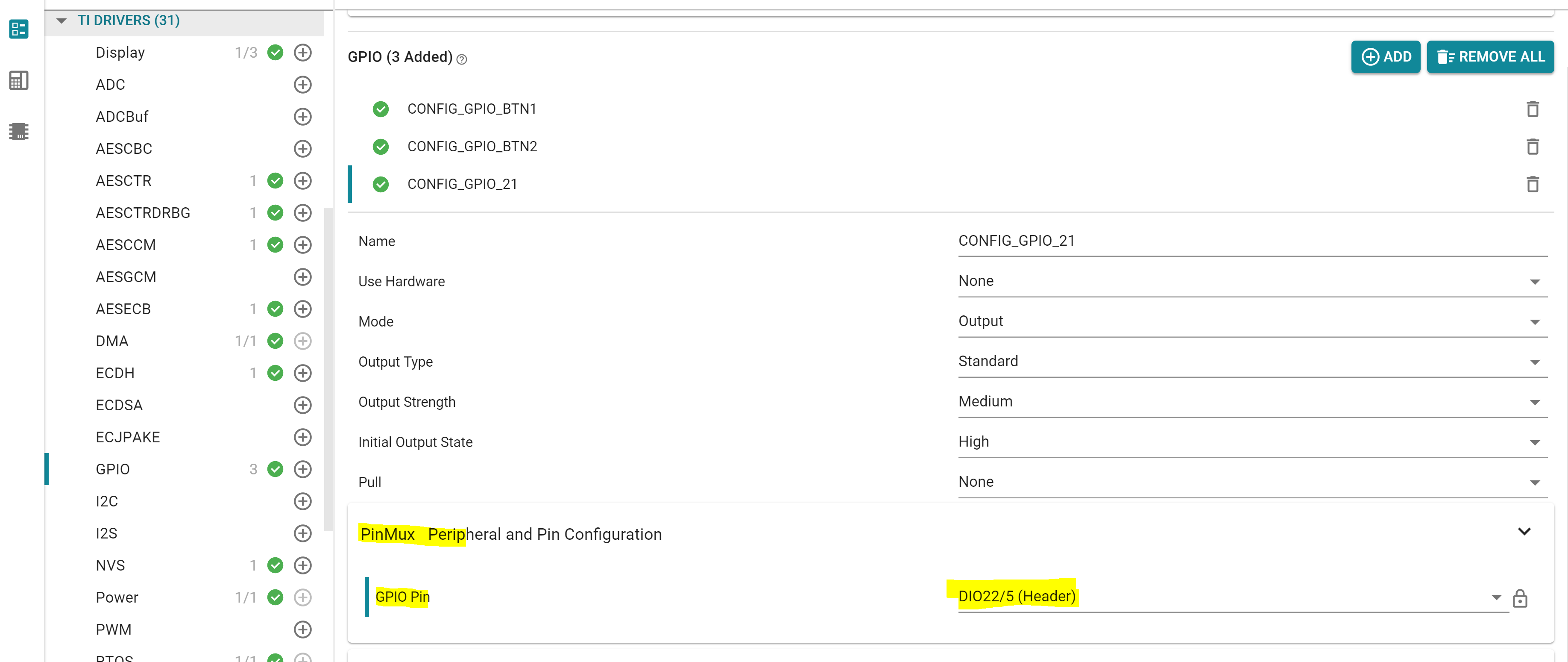

You can use SysConfig to do so:
Please review our SimpleLink Academy trainings for more details.
