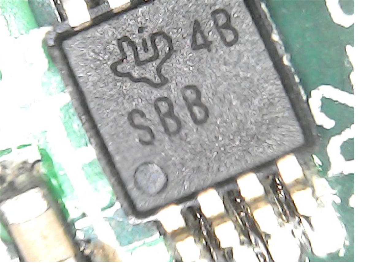

Code of semi conductor on SMD is "SBB" cann't find datasheet

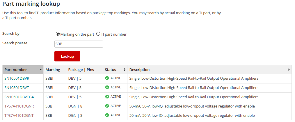

TI has a Part Marking Lookup tool.
https://www.ti.com/packaging/docs/partlookup.tsp#divline
Entering " SBB " into the query results in the following.
This indicates your device is a TPS7A4101DGN, the R or T at the end are : R= 2,500 | LARGE Tape & Reel T= 250 | SMALL Tape & Reel
