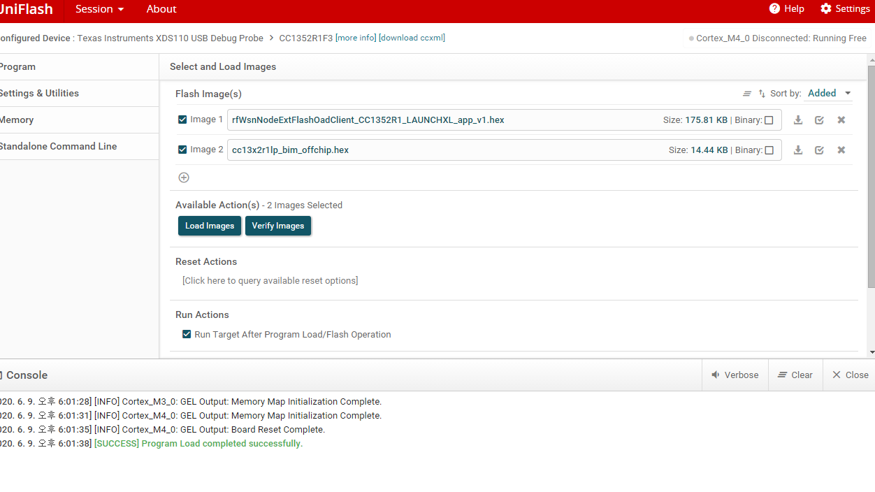

    load <SDK_DIR>/examples/rtos/CC1352R1_LAUNCHXL/easylink/hexfiles/offChipOad/ccs/rfWsnNodeExtFlashOadClient_CC1352R1_LAUNCHXL_app_v1.hex and <SDK_DIR>/examples/rtos/CC1352R1_LAUNCHXL/easylink/hexfiles/offChipOad/ccs/cc13x2r1lp_bim_offchip.hex into a CC1312R1LP
    using the Uniflash programmer into concentrator
    I followed the description of the file
    the uart print still same.
