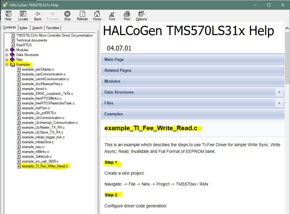

In my Project, we are using RM48L952 AND TMS570LS3137 board, i required to store some important data in Flash memory of both the board.
Can you please provide me a generic flash driver file which i can perform operation over the internal flash .
kindly help me, i waiting for your reply soon
Anand Kumar NS
  • Hello Anand,

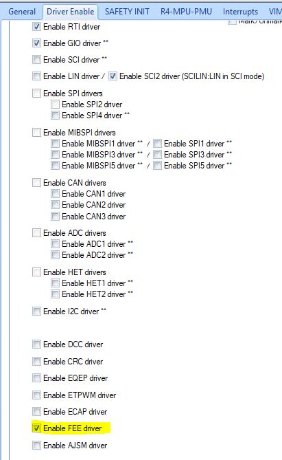

    Those Hercules devices have non-volatile flash for instruction execution or data storage. The flash bank 0 and bank 2 are used as program flash, and bank 7 is used as emulated EEPROM (FEE). EEPROM is erasable by the word while this Flash memory is only erasable by the sector.
    The FEE is supported by HALCOGen. The HALCoGen contains a example of using FEE driver generated by HALCOGen.
  • If you want to store the data to one flash sector in Bank 0 or Bank 1, you need to use F021 flash API to program the data to flash:
    https://www.ti.com/tool/F021FLASHAPI
